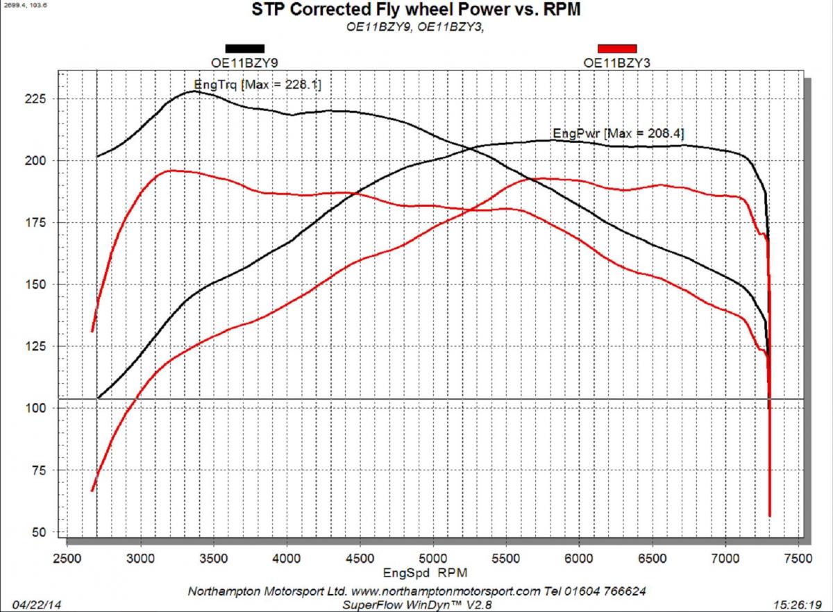

She even went on the Dyno. I'll try and dig out the graph soon.

graph please! :)
Managed to find the graphs.
Red lines are stock
Black lines are Revo stage 1 remap.
Very difficult to get a good run. When going to full throttle the gearbox kept deciding to kickdown. These were done at around 80 - 90% throttle to avoid the kickdown but it’s very close to advertised figures.
Completely transformed the car and I’m quite a happy chap.

Graph looks very smooth on delivery.  Don't know if it is a Dyno thing but my APR looks a bit more aggressive with a stronger initial torque spike but then a heavier dip during the super/turbo handover.  Looks well and 210bhp is good.
Kickdown is always an issue on dyno runs, but you don't need a full pedal depress to get 100% throttle, you get that before the kickdown switch.
Looking at the graph on awesome’s dyno. Not sure I'd trust the torque figure. It’s reading well over on stock.
I'm confident in the figures I've been given. Done at Northampton Motorsport. Very good dyno and accurate repeatable results. Do you know what gear the runs were done in?
We hooked up vcds when running the car and noticed that you only needed to get up to around 80% throttle for it actually to give 100% as the throttle map isn’t linear.
