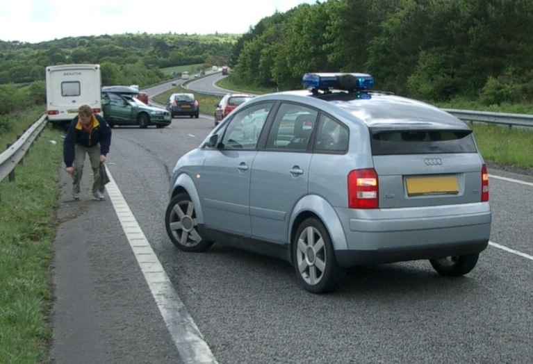

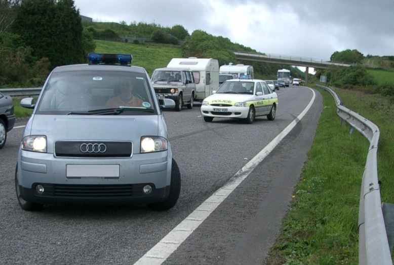

I don't own a caravan (yet). So I'm going by what someone told me when years ago, heading to Devon, a BMW and caravan jack knifed in front of me. It wasn't a pretty sight.
Sorry brining up an old thread like this. But I found an old hard drive today and found these pics. We were first on scene and my friend works for the London Ambulance Service and insisted we take his blue light in my Audi. Well it was used. And everyone in the BMW were fine.
