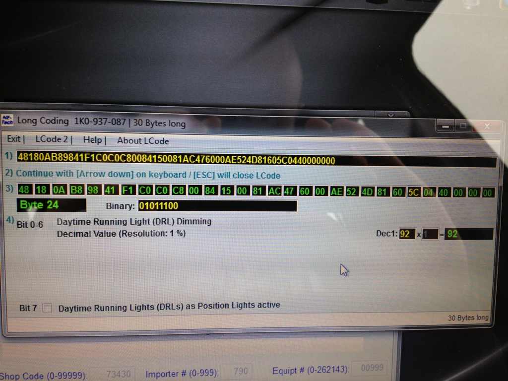

Hi peeps anyone know what the coding is to dim the DRL whilst indicating.
Screen shot here of where I got to with DRL activated via vcds also enabled now via maxi dot. I have headlights and rear side lights on. Just want the dipped headlights to dim while indicating.
09 vrs cr

Seems I may have the wrong byte number above.

Dimming only works on the facelift since its the only model with a proper DRL, pre facelift like the OP has the DRL is the headlight and as such does not and will not dim. The option might be there, but it will either do nothing or generate a fault code when you indicate. Just because the option is there, does not mean it does anything. The LE version of the vRS is sort of a hybrid and has the newer electrics and ECUs, but since it uses pre-fl components a lot of functions that can be coded directly with VCDS will not work.
Pre facelift the DRL option was very basic and basically turned on the headlights, that is all the DRL option does.
