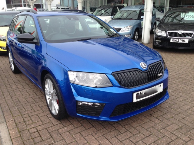

  • Here it is!   Front chrome grill and window trim with plasti dip!   Very happy with the final result! Let´s see how many months will last  :p   Mirror black covers already ordered from SuperSkod

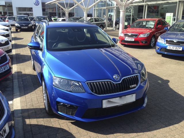

Another gratuitous shot:

Thanks, break it I will then as I have no interest in keeping the chrome one. Has anyone done the mirror caps themselves? I did my last motor, glass out, a few torx screws and was easy enough
Same procedure I think from what the dealer said :-)

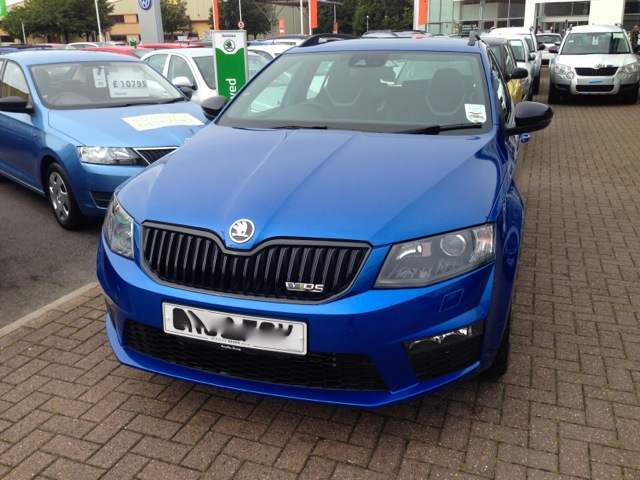

I've ordered the parts (black grill surround and mirror covers). They are sitting here at work on my desk......Am I going to be able to nip out and fit them in my lunch break? :-) Not keen on paying Skoda to do them. Has anyone else done the mirrors?
Today's update - Mirrors on, grille not yet due to the dealer who was doing it not being able to get the old silver trim off!  I may try myself tomorrow. CharleyB managed it, so I guess with some patience I could nail it.
Were the mirrors easy to fit?
Done and dusted!!! That was quite tricky!
The mirror caps..... easiest part. Popped the mirror off carefully, flat blade screw driver in and the cap pops off. Replaced and carefully clipped back into place!
The grille.......not so easy! Very fiddly (for a complete novice). Wasn't bothered about breaking the silver one, although it isn't a nice job to do. Used a flat blade screw driver (good old trusty flat blade screw driver!) to undo the top clip, then pushed one corner out, whilst pulling the front part out. Ended up snapping the silver gril into about a million pieces, but was too tight to pay for the dealer to do it, and didn't really want to take the whole bumper off.
All in all, good job. Looks much better in my humble opinion. I did try to order it after seeing loads on here with it, but mine was already being built by the time I asked about it. Superskoda were really good. Ordered the parts (around £108) and they came very quickly. Good job!
