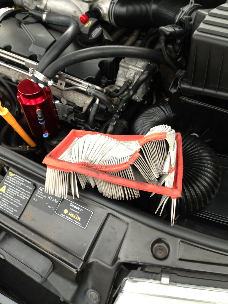

Here's a couple of my setup, just bent the bit of metal what the engine cover sat into as I don't use it anyways.
Where did you source your catch can?  I struggled to find one with 19mm hose attachments at the time and gave up so bodged my own using a 'magic bullet' container.  I've since done around 80k miles but doesn't look pretty LOL  BTW a screw cap from a bottle of any pop bungs the outlet nicely, I also used washing machine waste pipe which gives you an OEM look.  I also still haven't had the CEL light mapped out but it doesnt really bother me.

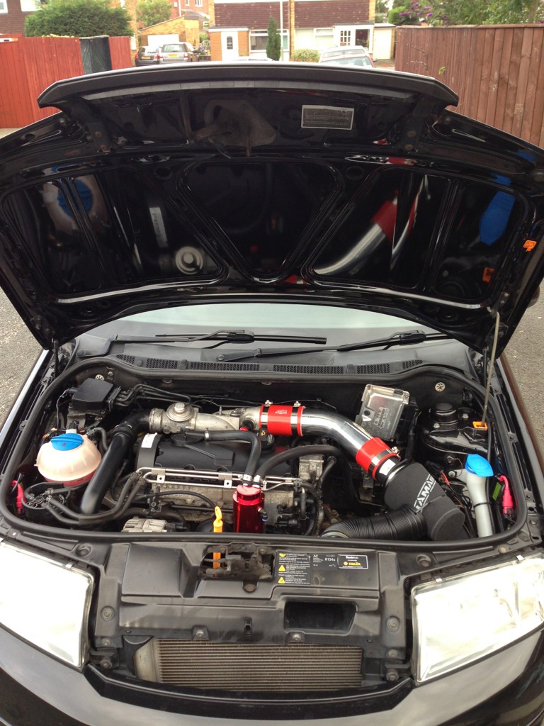

my set up:
hosses are now black rubber ones.
nice and descrete

you shouldn't need the CEL mapped out when you have done this mod, well it shouldn't come on anyways, I just bought the 15 mm outlets ones as the 19mm were about £100, mine cost £24 or something off eBay. Some will argue that 15mm outlets will damage your engine, I've never noticed anything yet.
my set up:
Posted Image
Posted Image
nice and descrete
Posted Image
what did you use to connect the 19mm pipe to te smaller pipe? :)
I used some sealing paste for plastics around the edge of pipe but to be honest it held its self in place by simply pushing it in.
Sounds like a bodge but it worked pretty well and doesnt leak.
Your catch can wants to be placed higher than your cam/rocker cover ideally,as condensation will go to the highest point :)
