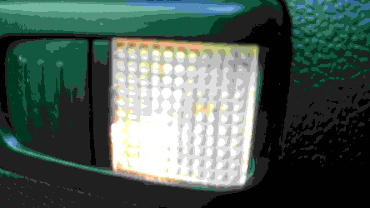

Symptom :One of the three LEDs appears to glow when all doors are closed and the car is locked.
Cause : when you tried one of those stupid replacement LED w5w bulbs in the boot door you created a momentary short and damaged the integral diode of the lamp holder.

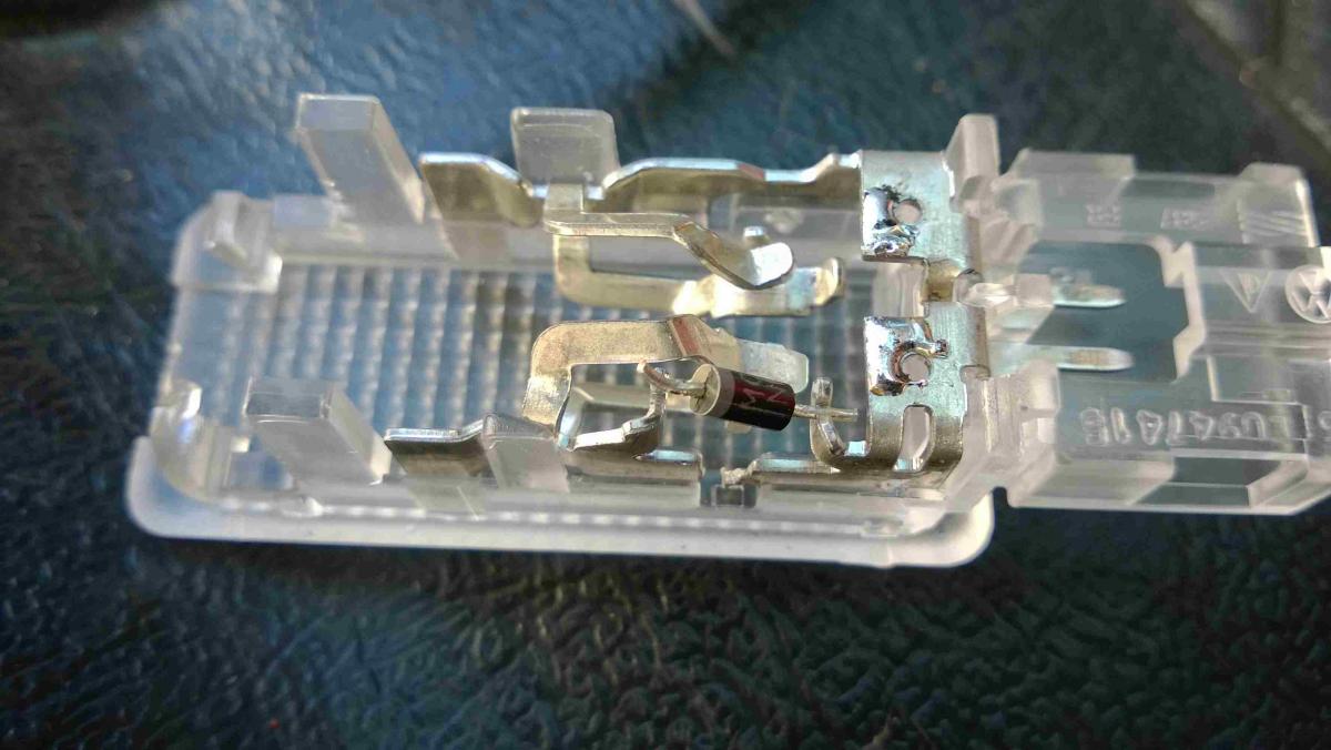

Cure: Remove the lamp holder(s) and disconnect from the car by pinching both sides of the plug and pulling.
Remove the bulb.
Either,
with a multimeter on diode test confirm the diode reads in both directions and replace,
or
with a multimeter on resistance check that you only get a reading with the probes connected one way (swap probes over so if red was on the left it is now on the right and black probe vice versa)if you get a reading both ways then replace the diode.
If you only get a reading in one direction, check the second lamp holder.
The diode is a 1N4007 (that's (oneN4007)) a very common diode that you should find at maplin or from your local tv repairer if there are any left.
The diode is a push fit, not soldered so just trim the legs to match the old and push into place making sure you insert with the solid band on the diode facing the direction the old one was.
The 1st picture shows the torch with one glowing led though it looks very bright in the picture (Nokia lumia is amazing at low light)
The second picture shows the boot door lamp holder and diode orientation.
