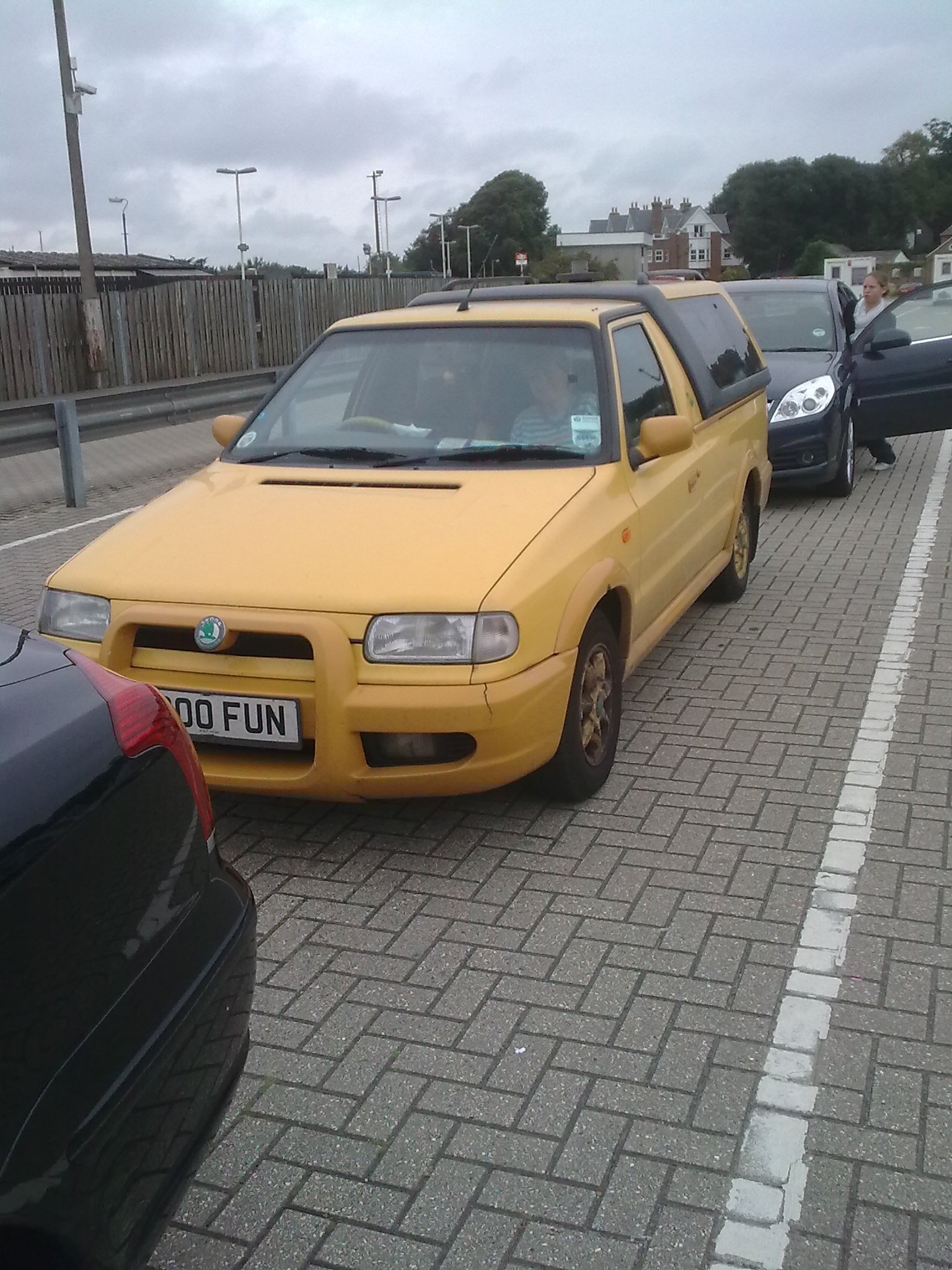

Yes it did but they were removed when I bough the Truckman top. It also had the long bars along the Truckman top, to which I used to mount a lateral bar & fitted a set of amber breakdown lights when I used it for recovery work. Attached is a picture of the Fun awaiting a ferry to the Isle Of wight a few years ago.
