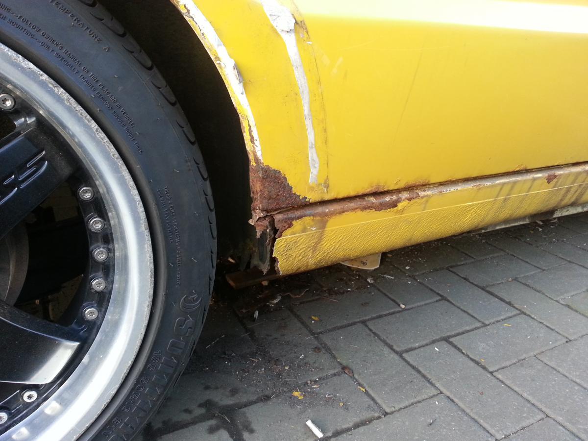

Needs welding on rear jacking point. Maybe a cylinder head, maybe a CV joint or engine/gearbox mount by the odd clunk.

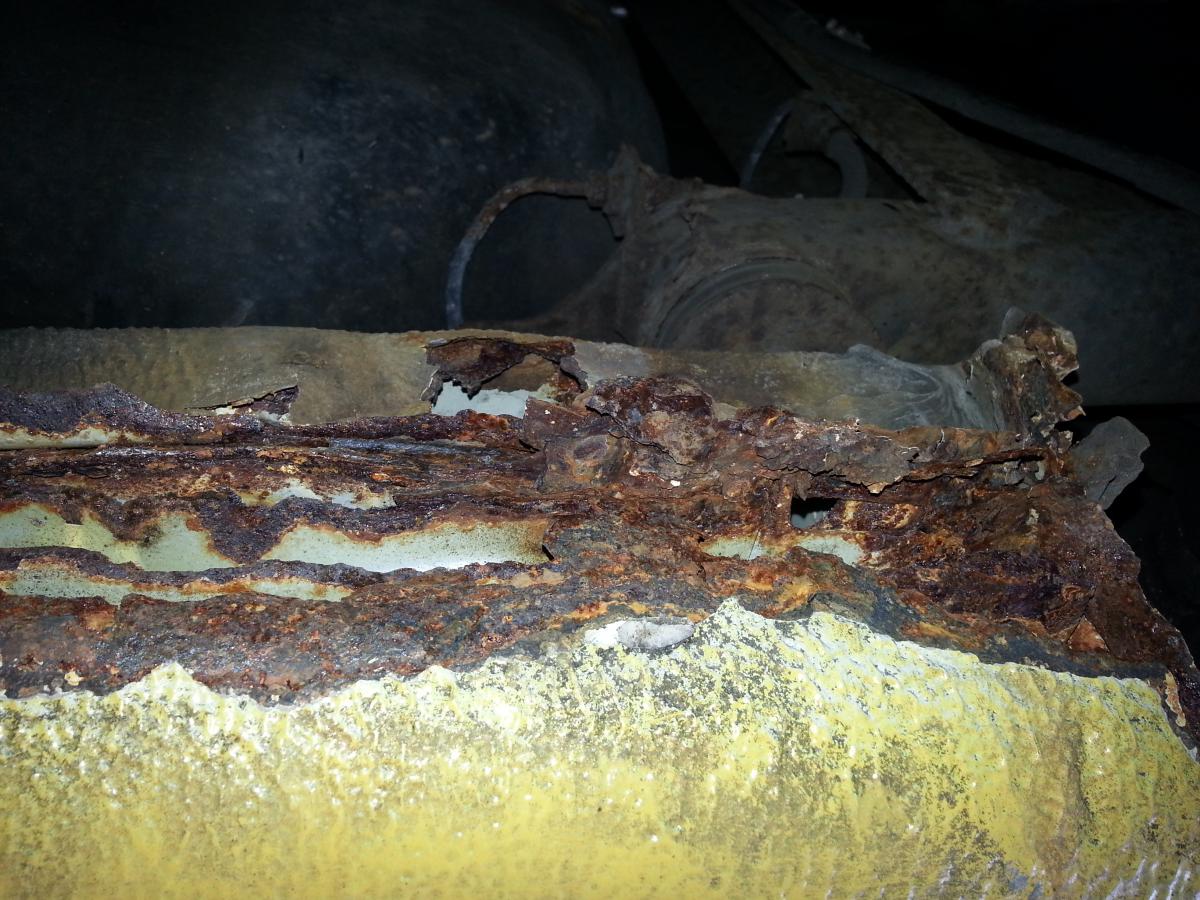

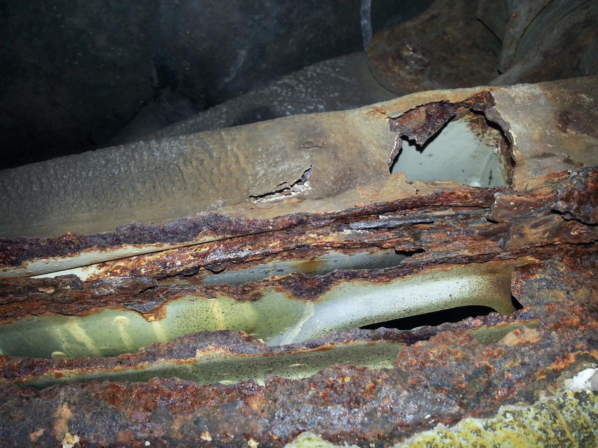

Offside and nearside (rear part of inner sill) suspension component mounting excessively corroded.
I really dread trying to get the sill covers off :-(

My funs as bad as yours mines under going welding work on its lack off metal on sills at rear and rusty wings and to top it off engine knocks and bangs and gearbox wines like my wife does just waiting on better weather so glad I stripping my conversation for the parts there worth fixing and keeping mines a really fun prob one off the 1st ones come on summer I wamt to get the spanners out.....

I am dieing to get mine out welding going well going to under sill the sills then but kit on mite help keep the rust away...
Update. Thanks to Hairymel from Retro rides for his help with the welding.
Coming on slowly but surely.
As always it looked better with the sill covers on :-)
After a little rust removal.
He has been working hard and O/S is done N/S started. The biggest problem is that the whole N/S rear wing panel is flapping around ;-(

Heres some picks off my rust in same place found a paint scrapper handy for cutting the arch covers off and a small chisel but scratched the crap out off the fun but got it off hole.. sill cover I just cut off as my fun came with two new ones.... and useing my slxi conversion hatch for the sills and inners and all over parts and mite stick the gti rear disks on and 256mm fronts wish gaffa tape could fix it.... got to love being a fun owner...
Sills are welded :-)  Thank you so much Mel.
