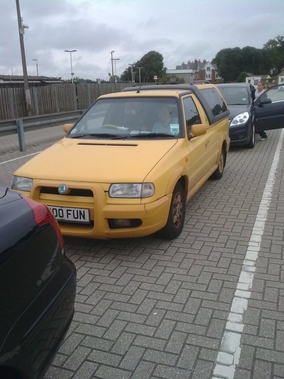

My new toy 'Fun'
they normally aren't as bad as they look, make sure you add your wagon to the fun truck register too.
