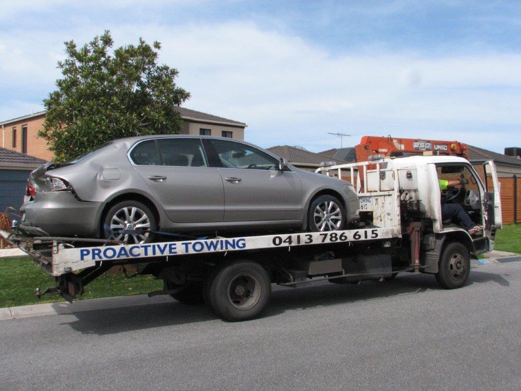

Looks like i won't have my Superb for a while. :(
Ouch indeed! everybody ok? Was it a texting teen or a sleepy lorrydriver? :wall:
Something quite tall hit you?  Looks like damage is "limited" to the bootlid, wing and tail light?
What hit you? The damage seems to be much higher than the minimun ground clearance of most commercial vehicles.

It was a 4WD Toyota with a bullbar on the front towing a dual axle trailer with about 2 tonne on it. Wet conditions, locked up and slid straight into me.
What the photo doesn't show is the creasing of the RH C pillar and that the roof edge trim has started to pop.
Looks nasty, hope everyone was ok. Can see what you mean about the c pillar. Can just make out a gap down the side of the window. At least your lights still work, you must have some strong bulbs.
I'd be surprised if they can get that shell straight again.
Fingers crossed for a write off and healthy payout.
Luckily I was the only one in the car as I was on the way home from work. It's shortened down the RH side enough that the fuel cap is jammed shut, the rear door gap is non-existent and the rear seat does not latch properly if folded and raised again. I'm hoping for a write off, as I have 2 year new for old replacement insurance and it's just over 15 months old.
C pillar damage should result in a write-off. It is essential for structural rigidity and will be extremely difficult to repair in a manner which would return it to 100% strength. Make sure that your insurance company provides you with a nice hire car until the problems are resolved. This helps speed things up, and your Insurance should not object too much because it appears the other party is at fault. Tell them you need a car of equal size, and don't settle for a Corsa or Astra.

This photo gives a better view of the c-pillar. Whilst the original image doesn't suggest much boot floor damage, a repair would very much depend on the availability of the c-pillar / rear quarter panel.
I'm assuming Australian body shops are going to have relatively up-to-date straightening technology.
It is so much conjecture, but these two images could still leave the actual boot floor and rear suspension mounting points where they should be;, a bit of a tug on a car bench could  make this a repairable proposition - but I'm looking at two jpegs from the other side of the world.  It's the assessor, and probably body-shop foreman, who will decide if they are going to repair, or settle.
I'm away from accident repair a long time now, but I'd say that could get away with a Cat.D, or at worst a Cat.C. rating in the UK.
Well, they are fixing it. Could take a while though. Replace rear 1/4, rear bar, lower under section, tow bar, boot, rear screen (scratched and couldn't be buffed out), upper twindoor hatch window frame including all hinges and mounts, all tail lights (one ok until screwdriver put through it during removal) and all boot trim panels.. Floor and rails appear not to be damaged although roof delamilated from reinforcing. C pillar has to be removed and replaced. L/H boot hinge needs to be replaced as well as all the electrics behind the back seats. Once fixed, off to Skoda for reprogramming.
The panel basher went to order the hatch section to find there are none in OZ, better still, according to him Skoda responded that there is no code for ordering one as nobody has replaced one before, seems that the car normally gets written off when the level of damage reaches the point where this needs replacing. Get this, they need to run one through the production line to get it built then pull it before it ends up on a car. Best guess three weeks, but don't count on it. So much for the assessor saying that all the parts would be in stock and the car would be ready in about two weeks.
