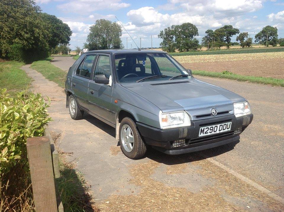

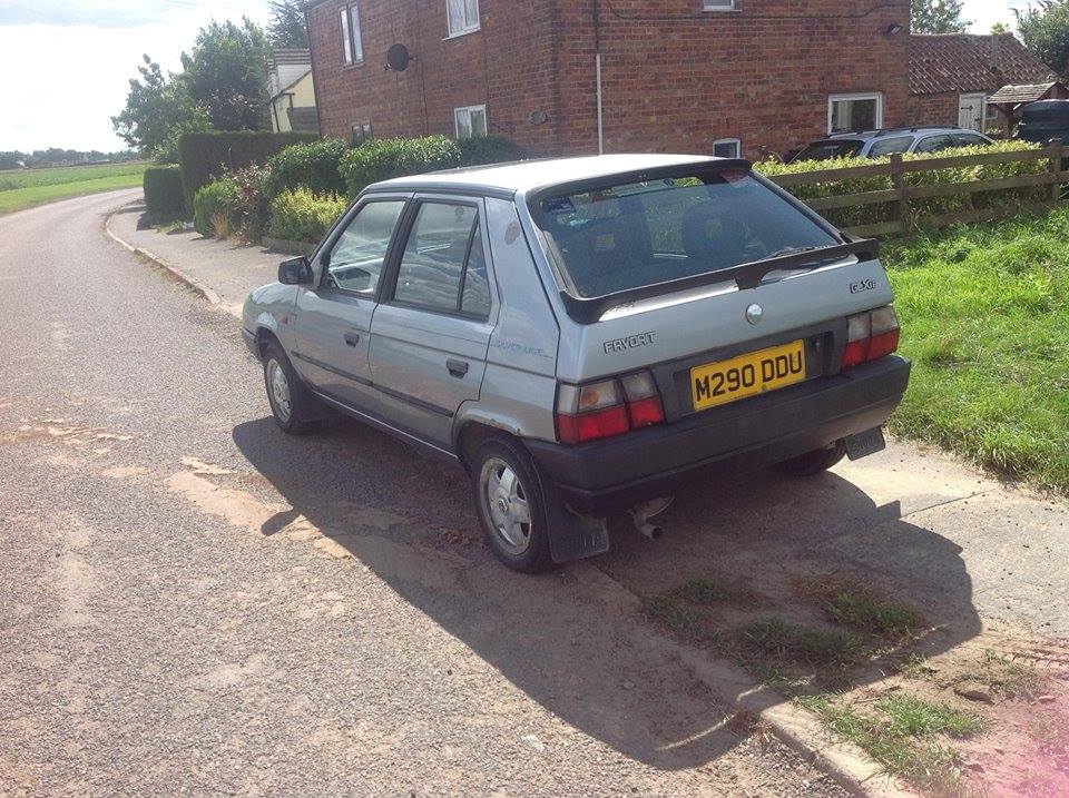

Hi there I'm new to the forum and thought I'd post here to ask for advice.
I've just brought a 1994 M registered Skoda Favorit 1.3 SPi that recently had the clutch changed (about 2 weeks ago so I'm told) and since the clutch was changed the speedo and odometer have ceased to function. The rev counter works fine but trying to figure out what speed I'm doing is proving more difficult than I thought.
My question is whether it's likely to be the speedo cable that's at fault and if it is speedo cable then where the hell can I found one as I've been told by Skoda this morning that they've ceased manufacture of the cable, is there another car that shares the same cable as I'd desperately like to keep the car going as they are becoming quite scarce now!
Thanks in advance for any help!
