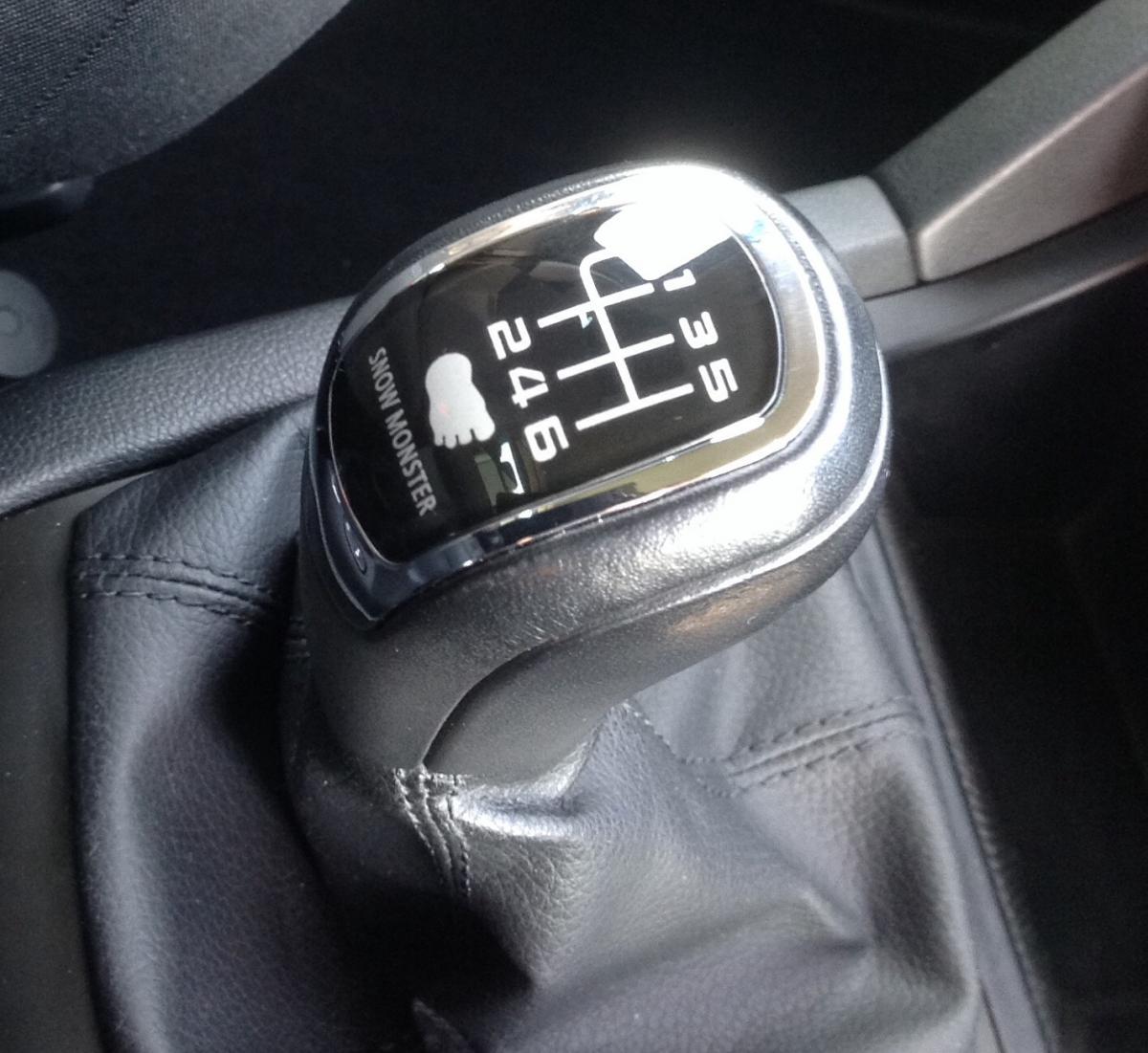

My gear shift plate was showing signs of wear so decided to change it for one of Super Skoda's.
I appreciate it's a relatively simple fix but always useful to have some reference.

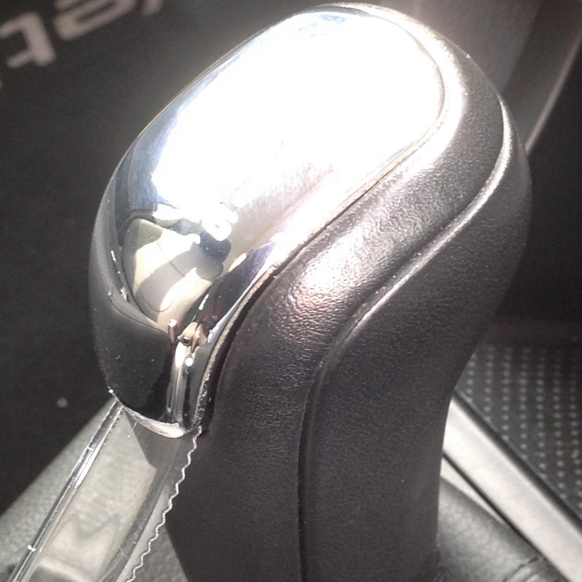

1/. I used a plastic picnic knife and carefully inserted it between the gear stick and the base of the plate. A little gentle pressure and the plate lifted.

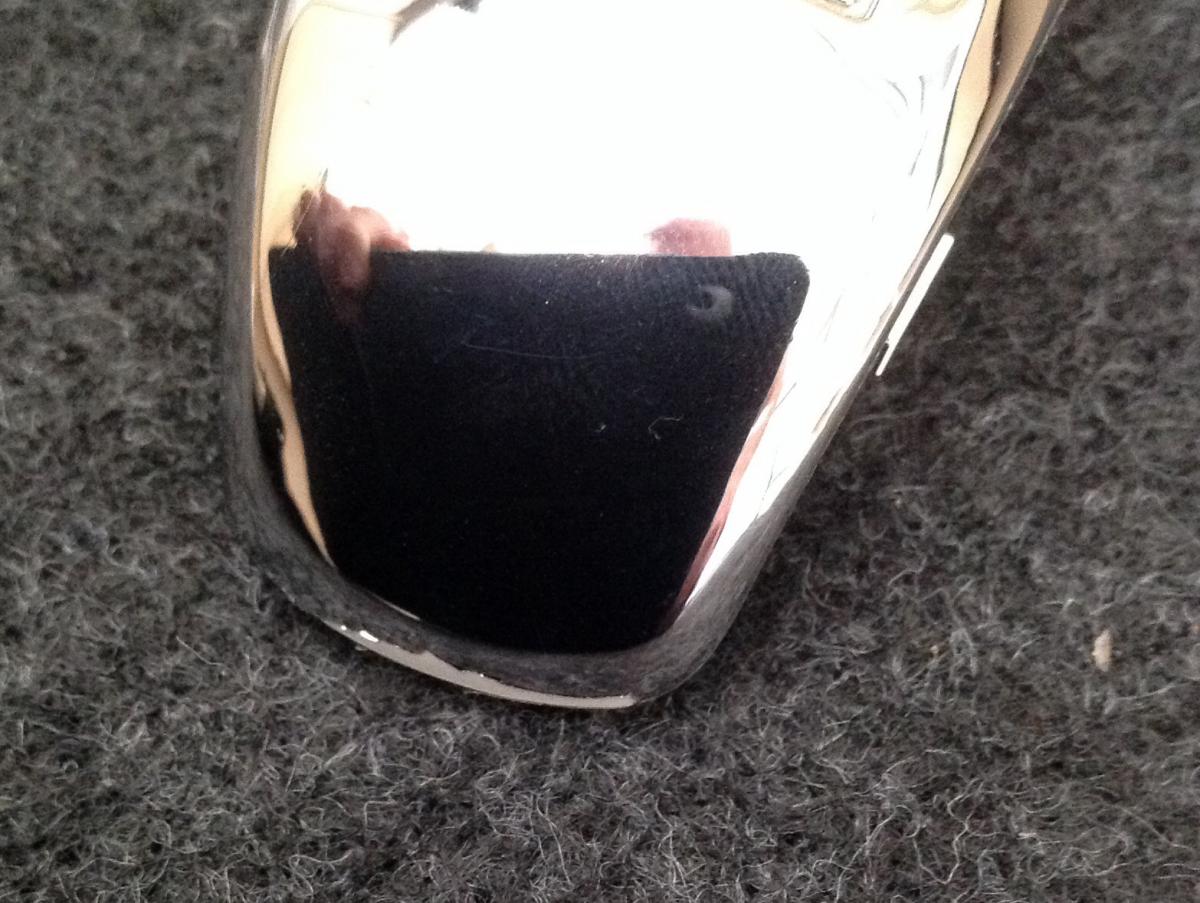

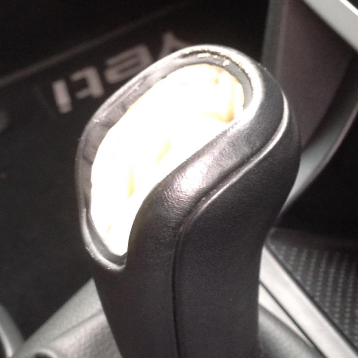

2/. Once it popped out at the bottom it was a case of gently teasing the clips out of the gear stick to fully remove.
3/. Refitting was even easier, position and pop it in!
I'm chuffed with the different design and feel the finish is better than that of the original. :)
