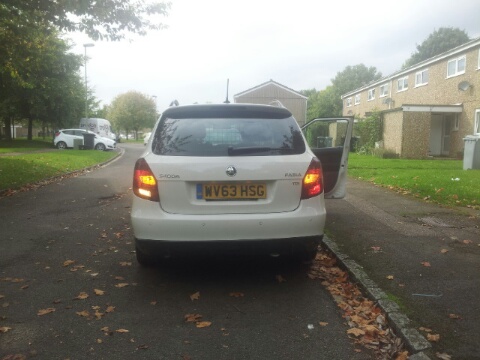

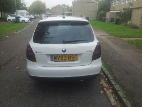

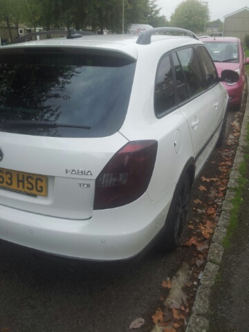

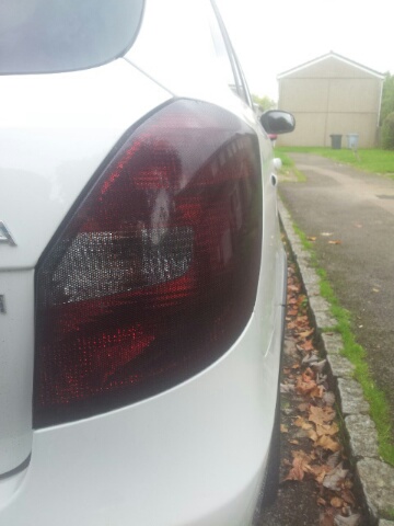

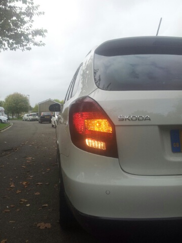

So heres a few pictures of the FlyEyes kit in place on the rear lights. i tried to get as many lights on as possible ( the only one not showing is the break lights!)
I do like it, but not up close!

looks good glen, even in daylight the lights look bright enough, in the dark they will be clear...
I'm of the same opinion as you though, i think they look good from a didtance, but a bit  crappy up close! here's mine...

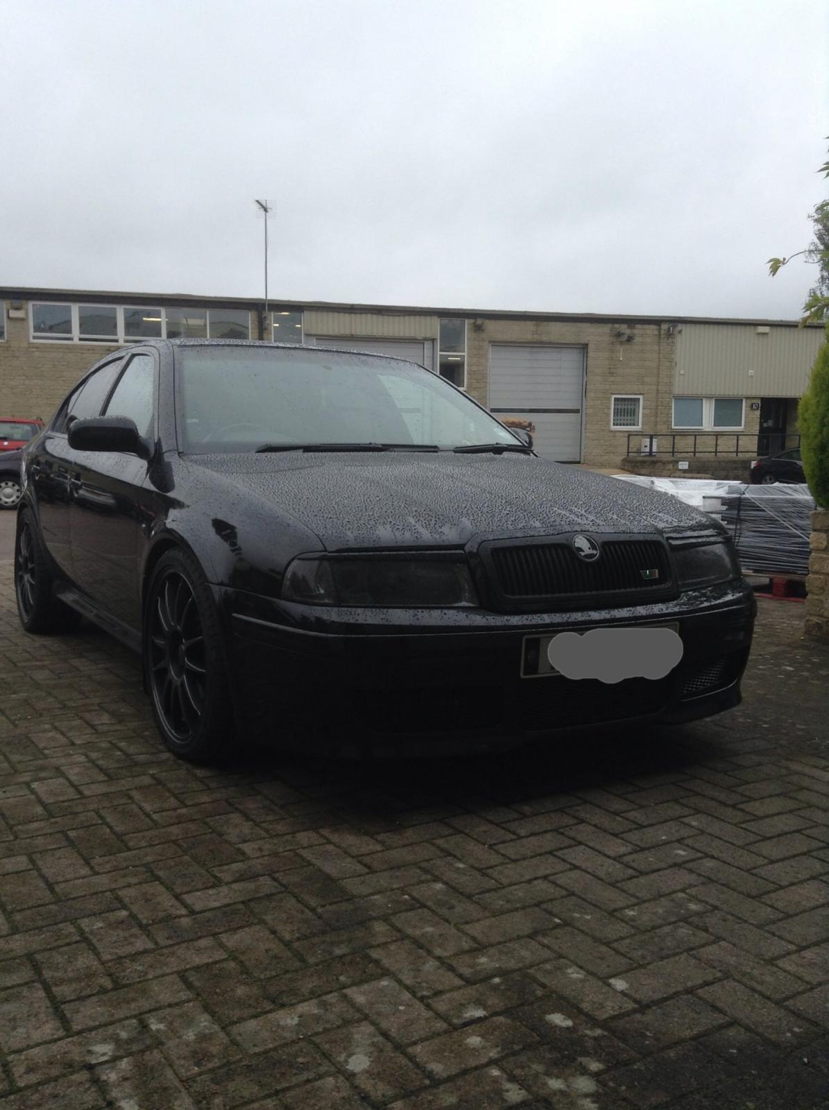

Looks good. I used Spi Vision on my rear lights and found similar results. Good from a distance but just not right up close. Also, the holes seem to trap dirt and feathers etc.
Light output does not seem effected but as said above anything over the lens will have some impact regardless of how much.
Tail lights in dark
Tail lights and indicators
Tail lights and reflectors
The darker lights do look a lot more suited to the car.

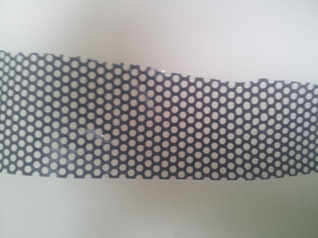

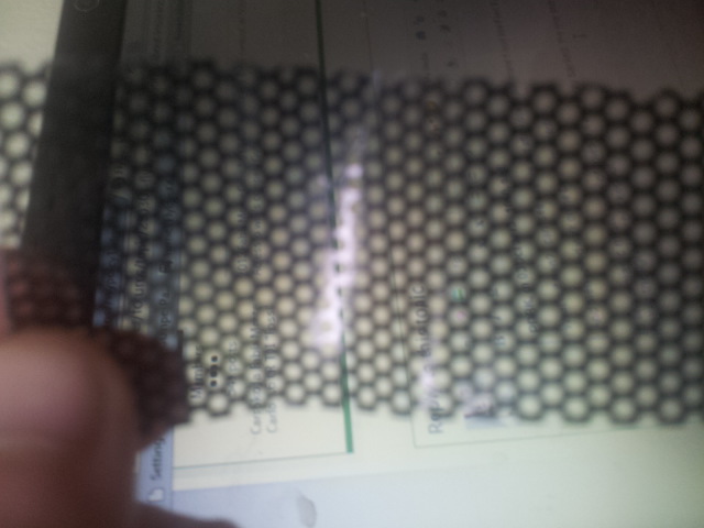

Its like a plastic sheet full of holes and sticky on one side. Heres some pictures:
I don't know how to tell my insurance about it! because im sure they will call it a tint but its not....the glass isn't tinted. a tint affects ALL the light produced by the light, where this stuff only stops 10% of light the other 90% is uninterrupted light.

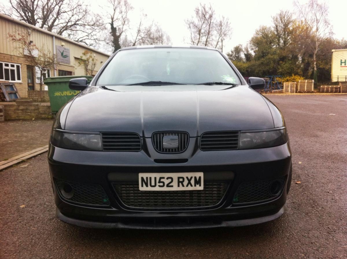

Here mine fitted..
Must say i personally prefer Lamin-X as doesn't have the silly little holes in it and dependant on tint is not illegal.
