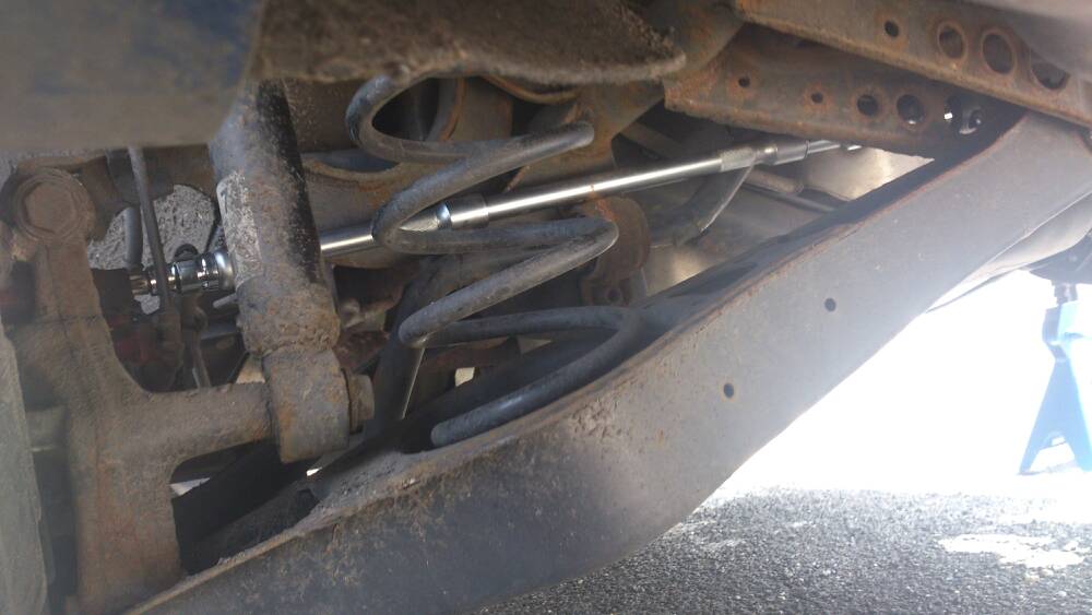

I have just done the rear's tonight and can confirm that access to the rear carrier bolts is absolute kak.
Once they are cracked they can be done by hand.
For the top bolt I had socket and ratchet straight down which just got enough room to undo.
The bottom one I had socket, 4inch extender and a uni joint then the ratchet came out to about 9-o-clock (as you look at the disc/hub)

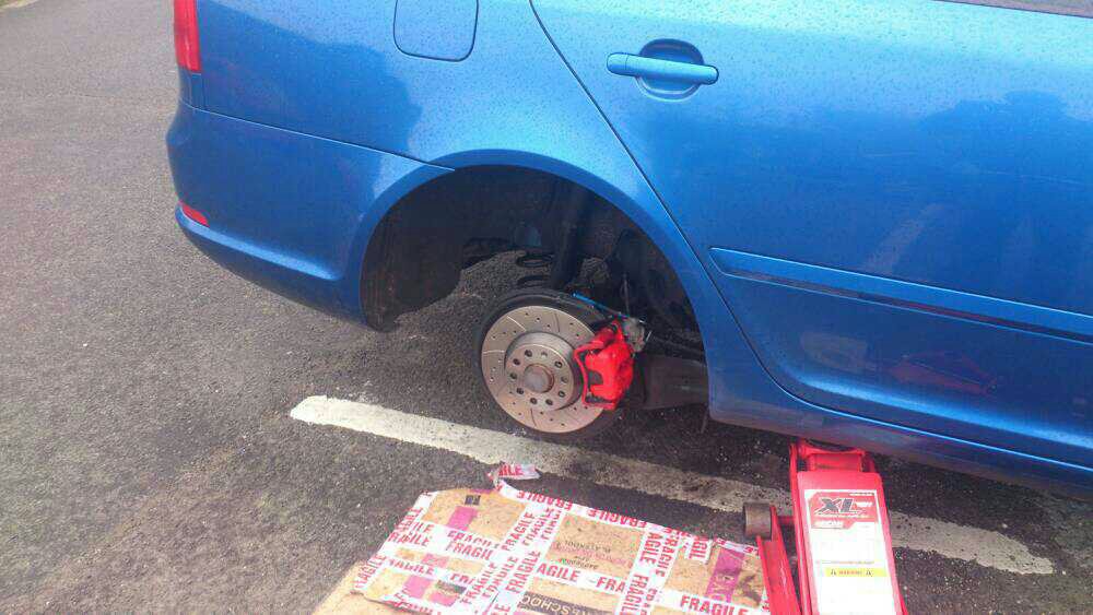

Yeah there the ones. I've just brought. Only got rears on at the mo but initial impressions are good.
Yep got me some of those a few months back too, had them coated also and bought green stuff pads for the front and mintex for the rears, they look nice under my black wheels.
