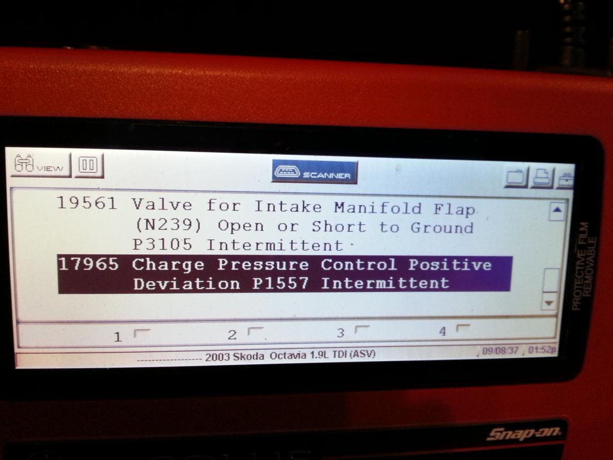

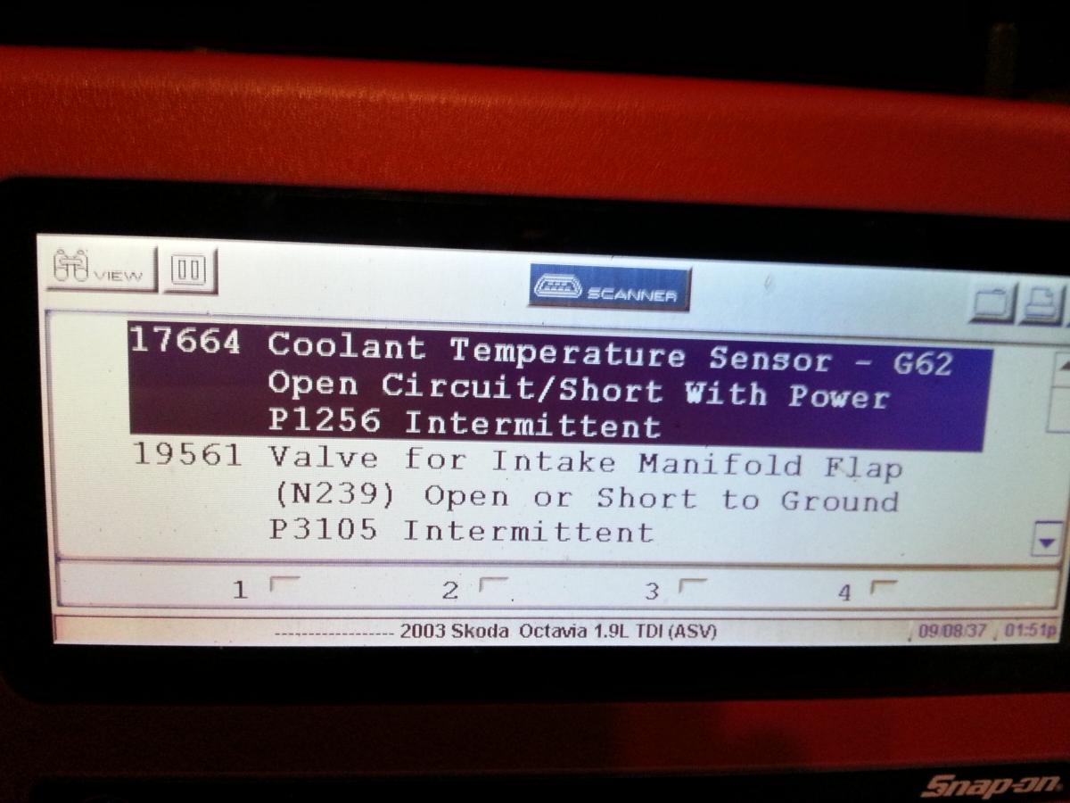

Hi I have just purchased an octavia 1.9TDi a month back the car ran very well with no problems, the other day while out shopping the car decided not to start when I returned to it i finally got it going then filled it up at the petrol station and drove it home I turned it off and now it will not start and has had me baffled since friday. I have had a multi meter on the two wires that are located on the fuel pickup valve and it is only showing 0.25 volts in idle mode and with the crank turning over. I have checked the fuses on the drivers side and all seem to be ok the fuel filter is also bone dry due to no pickup of fuel. I have had a diagnostic machine on it tonight and it shown some faults which were cleared and did not return the codes were:
valve for intake manifold flap open or short.
charge pressure control positive deviation
collant temperature sensor g62 open circuit/short with power

charge pressure control positive deviation = sticky turbo vanes (probably), won't affect starting
valve for intake manifold flap open or short = guess this is the anti-shudder butterfly valve on the EGR assembly.  If stuck shut then the car won't start (no air)
coolant temperature sensor g62 open circuit/short with power = if the old black sensor these are known to cause problems, replace with a proper green one (don't go with a cheap ebay option).
