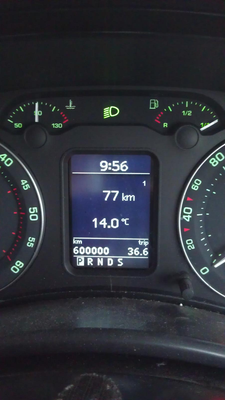

post-22824-0-07064200-1382138044_thumb.jpgMine is a 2006 BKD. I would say they are a safe bet for reliability.

The DMF was revised around about 2007 so if you get yours done,you can expect the new one to last a lot longer. Mine went at 130,000kms and the replacement is still in at 600,000kms!!

attachicon.gif2013-10-18 09.56.34.jpgMine is a 2006 BKD. I would say they are a safe bet for reliability.
Hi k.young, how are you getting on with the DSG with that amount of distance on it?
It's fine, it can make the odd "clunky" change at coasting speeds and it has only ever froze/stuck in a gear twice over the 600,000kms. I think it has had only 3 oil/filter changes!!!!
