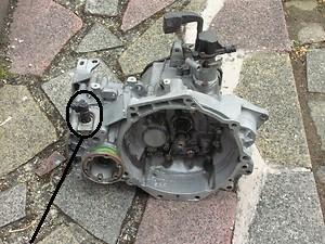

All the Fabia's are electronic for the speedo, most use a sensor that is on the rear of the gearbox but I would try to find a friendly garage to read the fault codes first as it could also be a wiring fault or faulty speedo itself. Most likely is the speed sensor but are there any warning lights on the dash at all?

No the sensor is definatly at the rear of the gearbox see pic attached.

I have a Haynes Skoda Workshop Manual. Mainly to help carry out simple tasks. I cannot see the item you refer to in the picture. My Skoda is a 1.4 16v fabia 2000. Do I presume you are referring to my car?
Where is the gear box? ( I'm amazed I cannot see this information in the manual) Can it be seen from the top or must it be viewed from the bottom?
Standing at the front of the car adjacent to number plate and Looking down from the top with bonnet up: is it to the left, right, top or bottom near bonnet catch?  And looking up from underneath is it left, right, top or bottom near number place?
