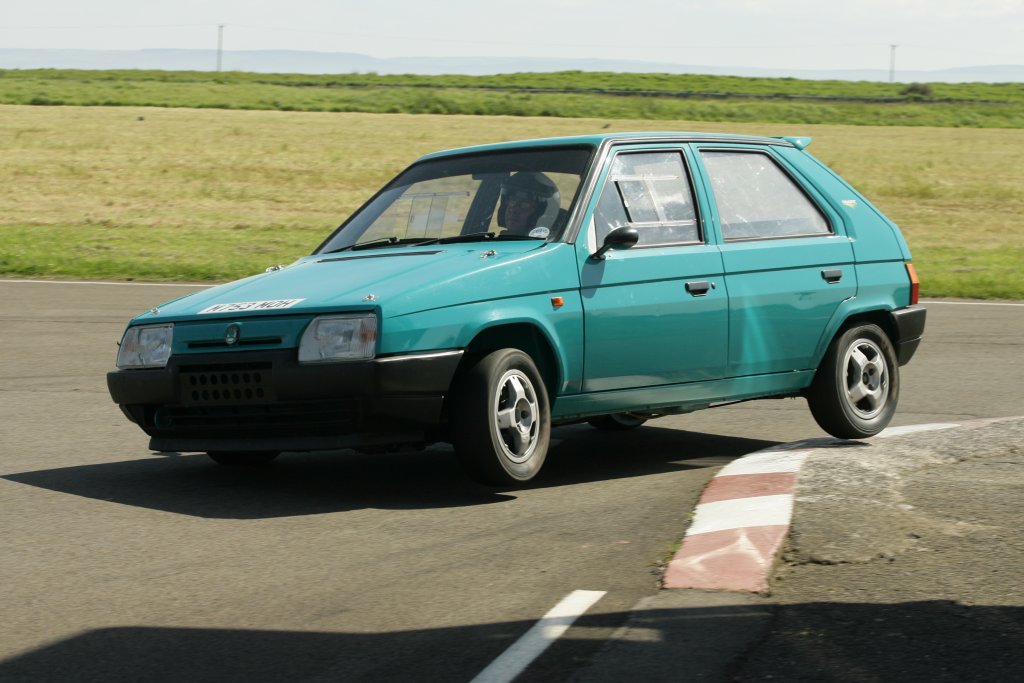

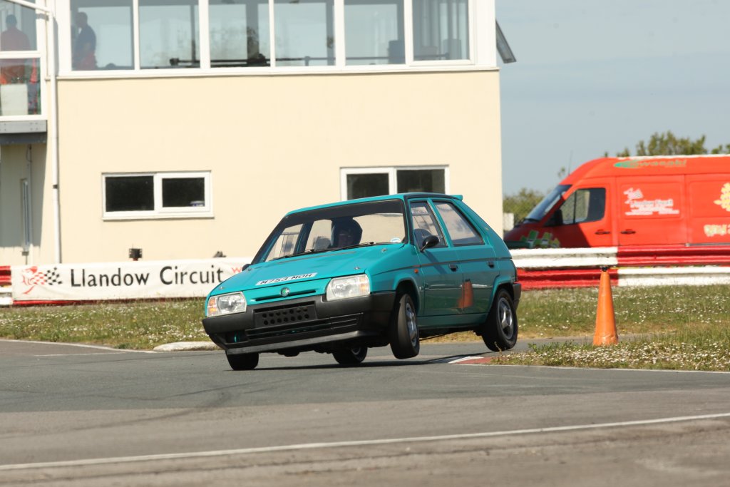

A snap from Llandow today. Great fun.
Edited by Favorit Ken
Three wheels on my wagon :D
How about, two wheels on my wagon ?
