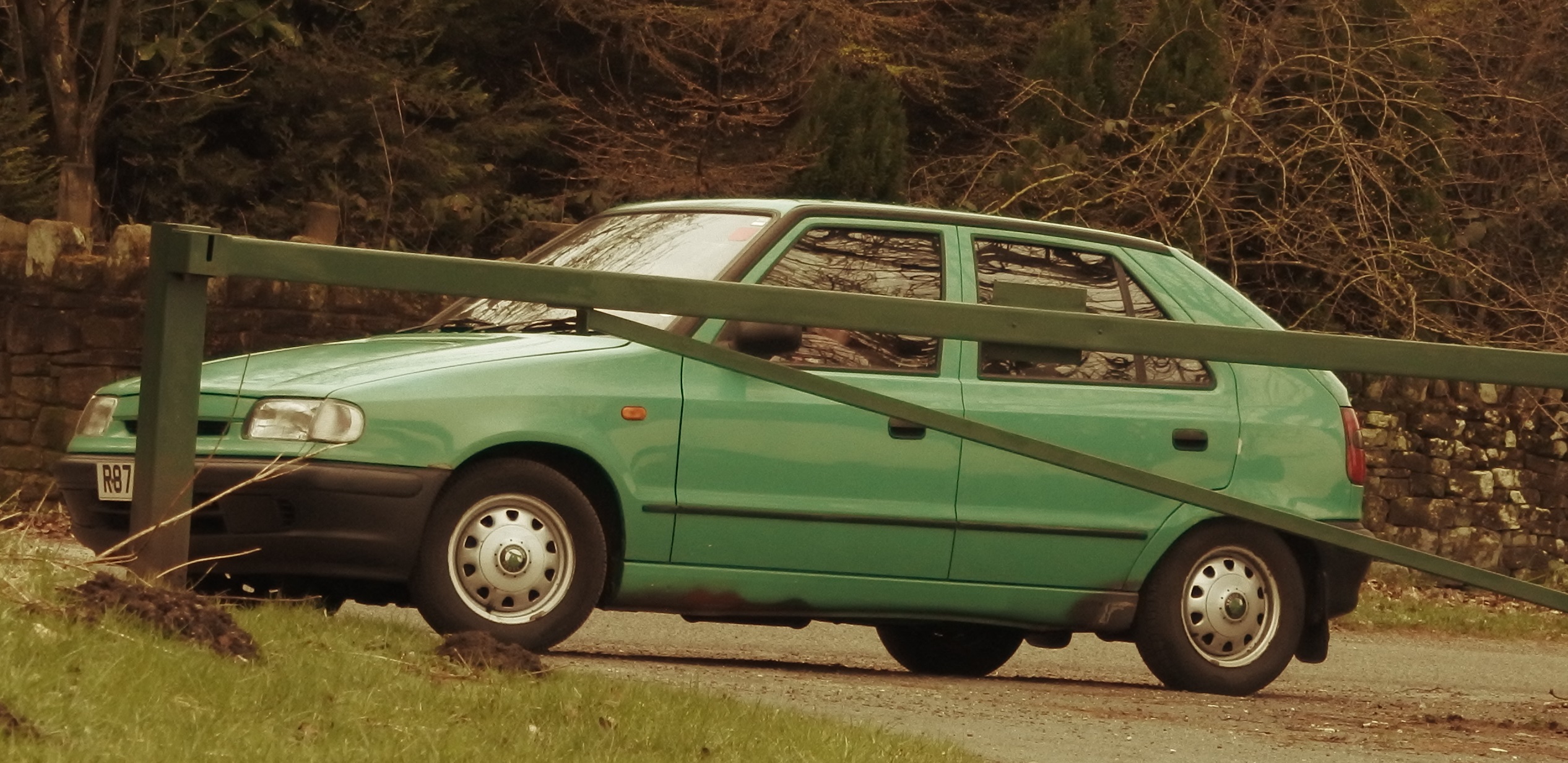

Kermit. Perhaps highest BHP 8v 1289cc Favorit in UK
Altered the trigger disc spacer/holder so I can get a socket on the crank bolt to turn the engine over if necessary.

  • Side skirts on and track wheels fitted:
  • Next is lightening which helps acceleration, braking and handling, all in one go and I’ve managed to get Kermit down to 685kgs, with about half a tank of fuel. He’s been on a diet of: Interior str

I’ve been working on replacing the original pedal set up i.e. the lever mechanism that transfers the brake pedal movement from right side of the car to the left side. Thus reducing weight, frictional forces and adds mechanical advantage. It’s been a bit of pain and it’s not finished yet but I can at last see light at the end of the tunnel. I’ve had to buy two universal pedal boxes ‘cause the first one turned out impossible to fit, a lathe and a plasma cutter. Trouble being, there’s not a lot of room, here are a few photo’s that perhaps explained the problems better.
I'll post more as I tidy and sort the rest out.
Sorry the above is in the wrong order , I don't appear to be allowed to edit it but I'm sure you guy's can figure out the right sequence.
