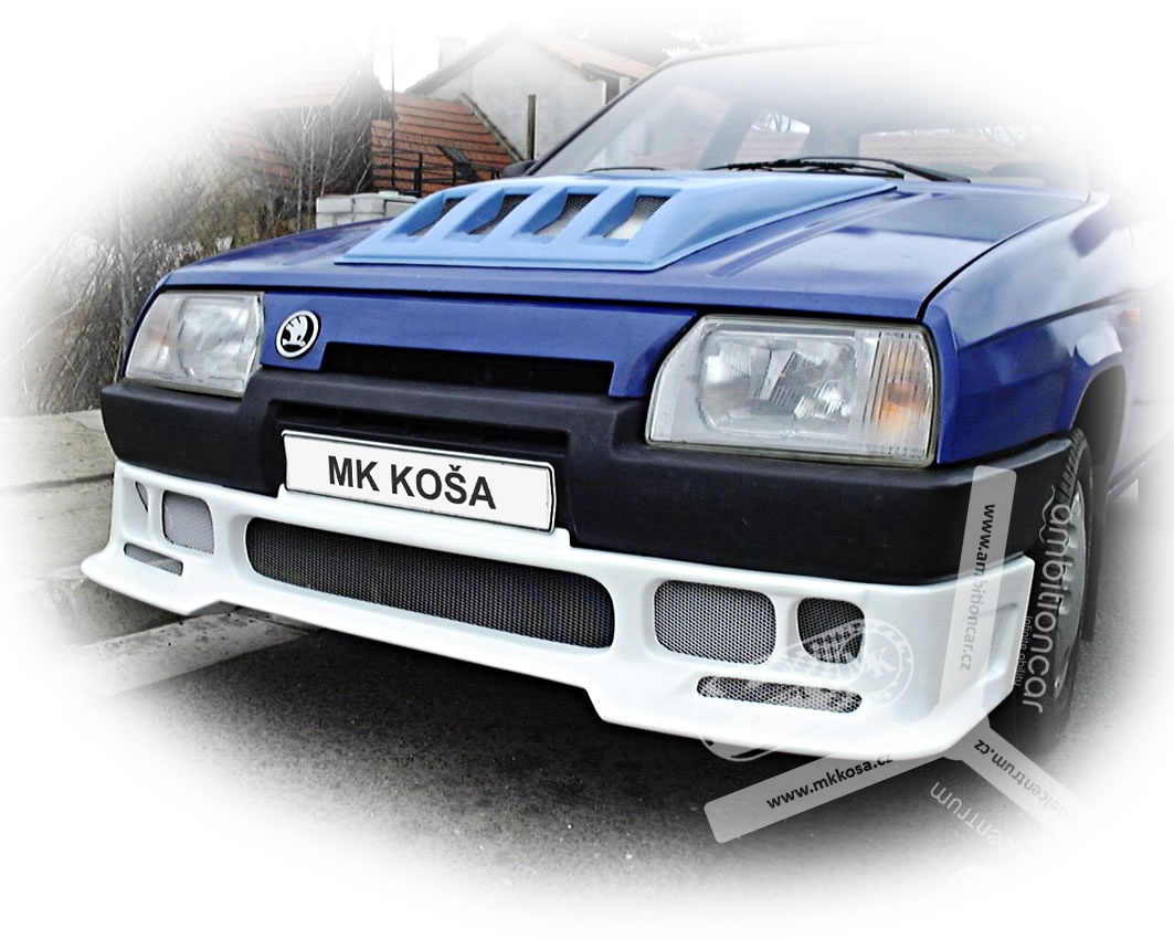

Done a bit more. Bought this splitter from Czech but had to modify it quite a lot to get it how I wanted it. It's not quite finished but nearly there, just got the finish some brackets and some fibre glassing behind it, where you can't see. Hoping it will help the aerodynamics and also (with the ducting I've put it) the air to the radiator. I have some side skirts to fit as well and I'm gonna make a defuser for the back.

BTW this is how it looked before I altered it:
Oh dear, yours looks much better!
Well thank you sir. I took a bit of risk buying it but I'm fairly happy with it now. I'd never done fiberglassing before you see.
You've done a nice job with that splitter; it looks much, much, better now.
