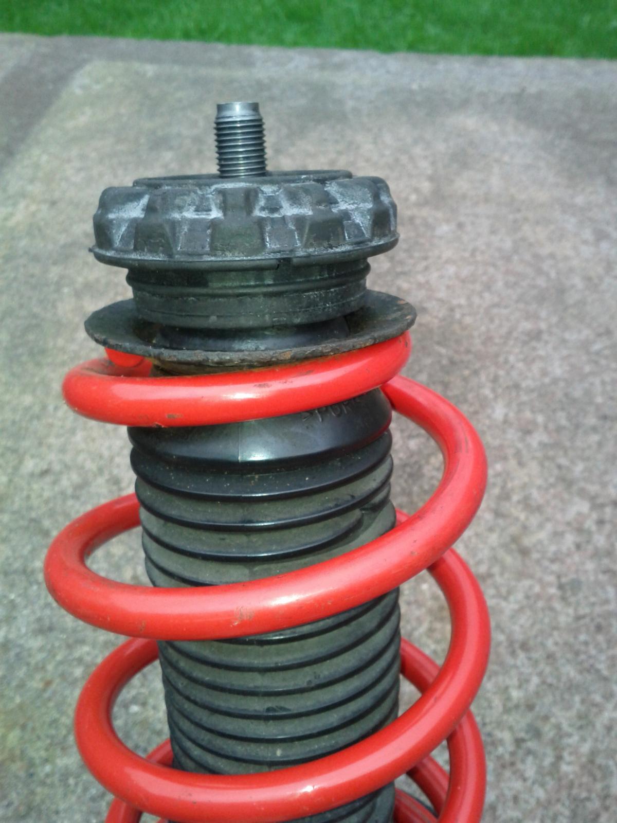

I've recently fitted some cobra -30mm lowering springs to my Octy mk1 Vrs. I didn't fancy coilovers really as I didn't want to go that low and comfort was important. The front looked really good not too low and the car drove well ( new shocks fitted too ). However, as has been mentioned before regarding springs on these cars there was an issue with the rear going way further than the front and really looked strange. Not wanting to go out paying more money for coilovers I was wondering if I could fit some adjuster perches from a coilover set to raise the back end up? Does any one know if these will fit a standard size spring or are the coilover springs wider? I've started looking at prosport coilies but as I've mentioned I've just bought lowering springs plus 4 new shock absorbers!!

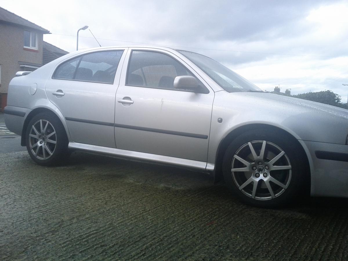

started with this silver 4x4 look!!

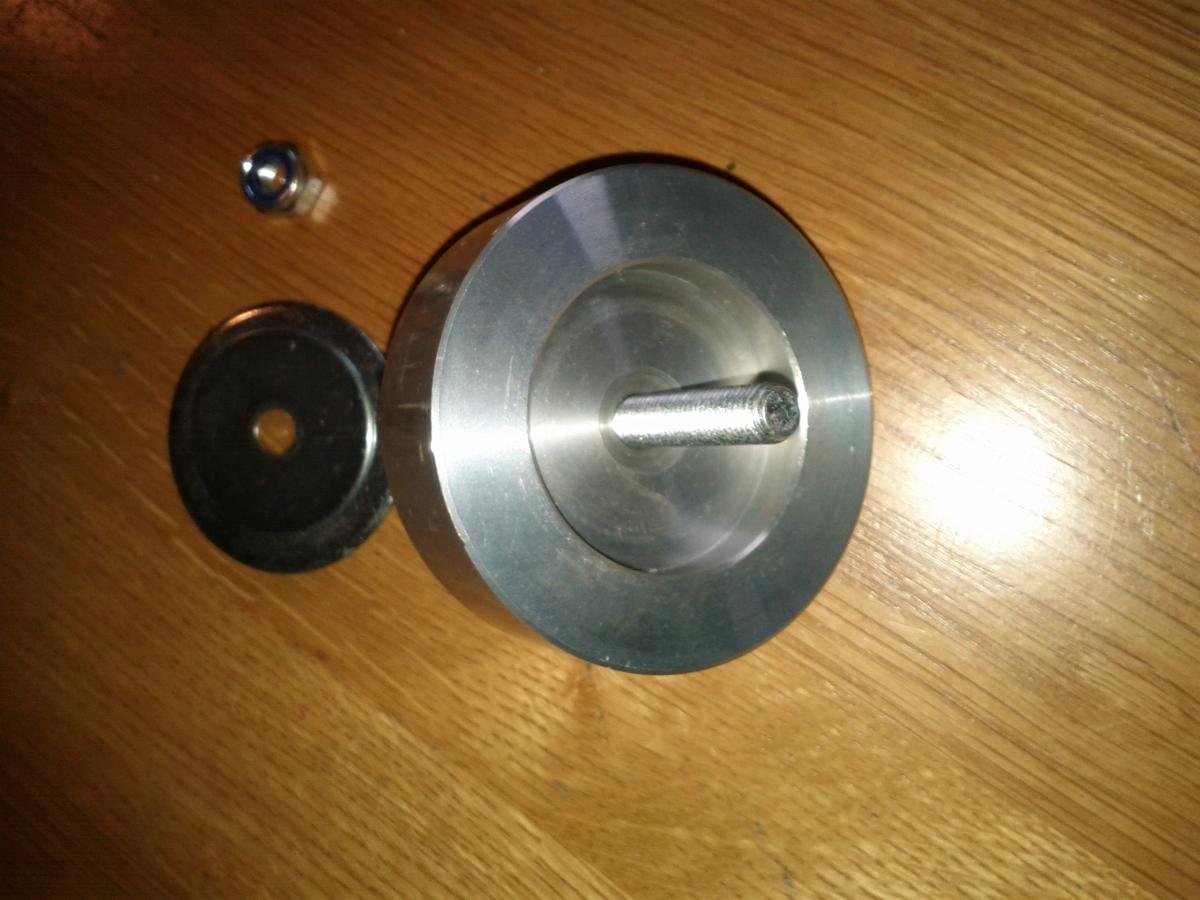

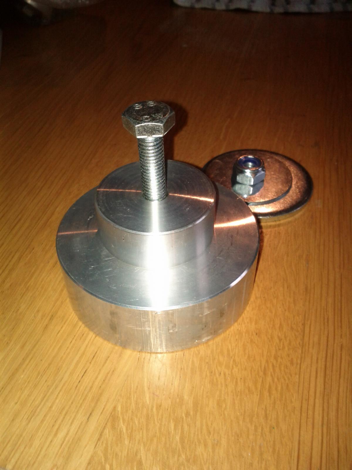

I then had some alloy seats/perches made. these were made to fit the rear beam to the correct size.

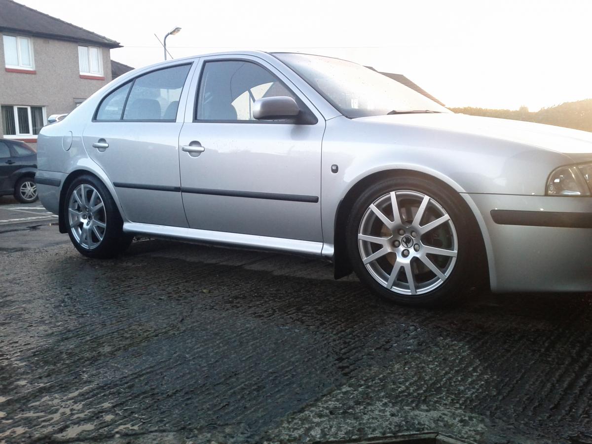

End result.
Overall i`m happy with it. Its not too low but looks better than standard. The ride is still more on the comfortable side. Its a little stiffer than standard but it needed to be! Great compromise. in total the front has gone down 25mm with springs plus another 15mm with polo top mounts. The rear as it is now with the spacers on has gone down 30mm.
