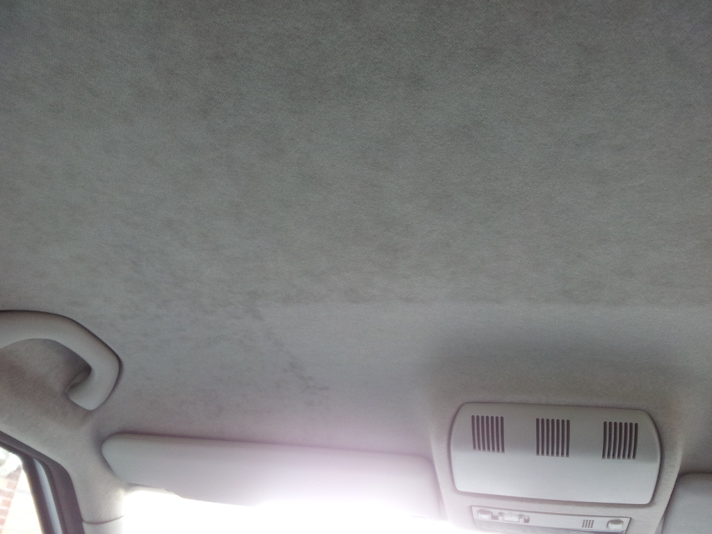

As per my other thread, i picked up an 08 reg Fabia II recently. The headliner (ceiling) seems to be stained with mould or something similar, apart from a square around the cabin lights at the front. Has anyone else noticed this? It seems dry as a bone, even in wet weather... so i'm wondering if the previous owner was doing something resulting in high condensation levels up there.
I've tried carpet troubleshooter, vinegar and valetpro enzyme cleaner and nothing seems to shift it, so does anybody know a) where i could source a replacement headliner from, b ) how easy it is to fit, and c) is it likely to return over time?
Also, what's in the square around the cabin lights that would stop mould from growing there?

As some of the Fabia's do suffer with extreme internal condersation, I would imagine it has something to do with that, mould doesn't grow on glass as easily - unless it is really dirty, so my second guess would be the headlining - as reported here because it retains moisture also.

Re-looking at the test areas, the carpet troubleshooter spray actually seems to have made a just-about-noticable dent in the mould... maybe a few applications will help. The only real issue is not being able to scrub it with anything as the headliner material falls apart... I used a sponge to gently rub it in and that changed the texture so anything more vigorous would rip it to shreds i reckon. Maybe i should just spray and leave it?
I can't find a new headliner anywhere online, might have to ring my local Skoda place and see what they can do.

Its Mildew, the best mildew cleaner I've used is this spray. Once mildew has stained material, its usually impossible to remove the stain.
