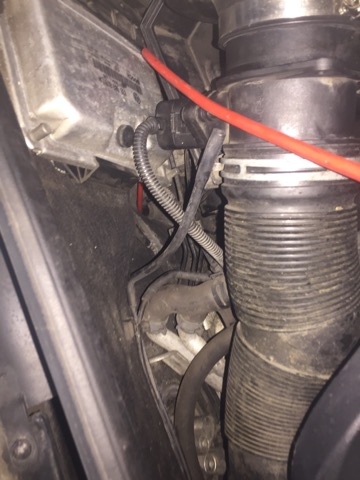

Removed wipers and plastic found a hole in the right corner pushed wire would cound't find it inside the car...  Shall I remove wheel arch to actually get the wire through?  where exactly is the hole to lead it into the interior ? Stripped all of the plastics including glove box still nothing giving up :s help! anyone got pictures how you done that ? thank you .

On the passenger side there is a bung where the bonnet release would normally run on LHD cars. Lift the scuttle panel up and remove the bung then you can feed a cable through and it will come out behind the glovebox. You will need to move some of the soundproofing out the way to find the cable when its been pushed through. You need to go from outside to inside otherwise you'll struggle to find the hole inside.

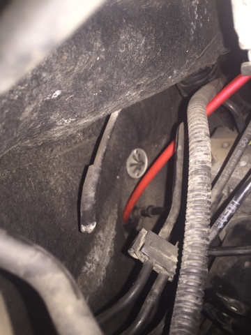

Was struggling finally found the hole -.- Anyone knows why that black  pipe leads from interior into the engine bay ? it looks useless

Don't think that's the intended hole (but it'll do). Black pipe is rear screenwash feed I think.

that pipe is cut off :blink: Was looking at it couldn't really see anything . was scared to pull it out didn't know whats that and yes just installed it today.
I presume your rear washer doesn't work then?
I didn't disconnect it thats why I didn't know where it's that from. you was right it was a screen wash pipe just got abit confused.
