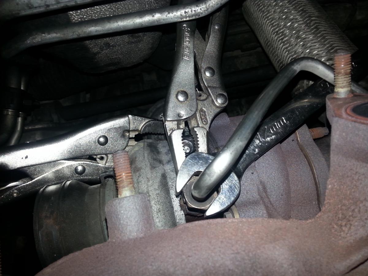

As you have recently done your tubo.. know the oil feed pipe . Its like a brake pipe fitting. But that union first bolts onto the turbo... when I come to take the feed pipe off the turbo. .. the bottm of union to turrbo cracked loose. But the union to feed pipe side stayed tight !!! Causing the hole pipe to try and turn. . Had to improvise and use 2 sets of mole grips to firstly hold the actuator rod out the way. Then try amd hold the bottom union still while I cracked off the top nut. !! Wasnt fun.

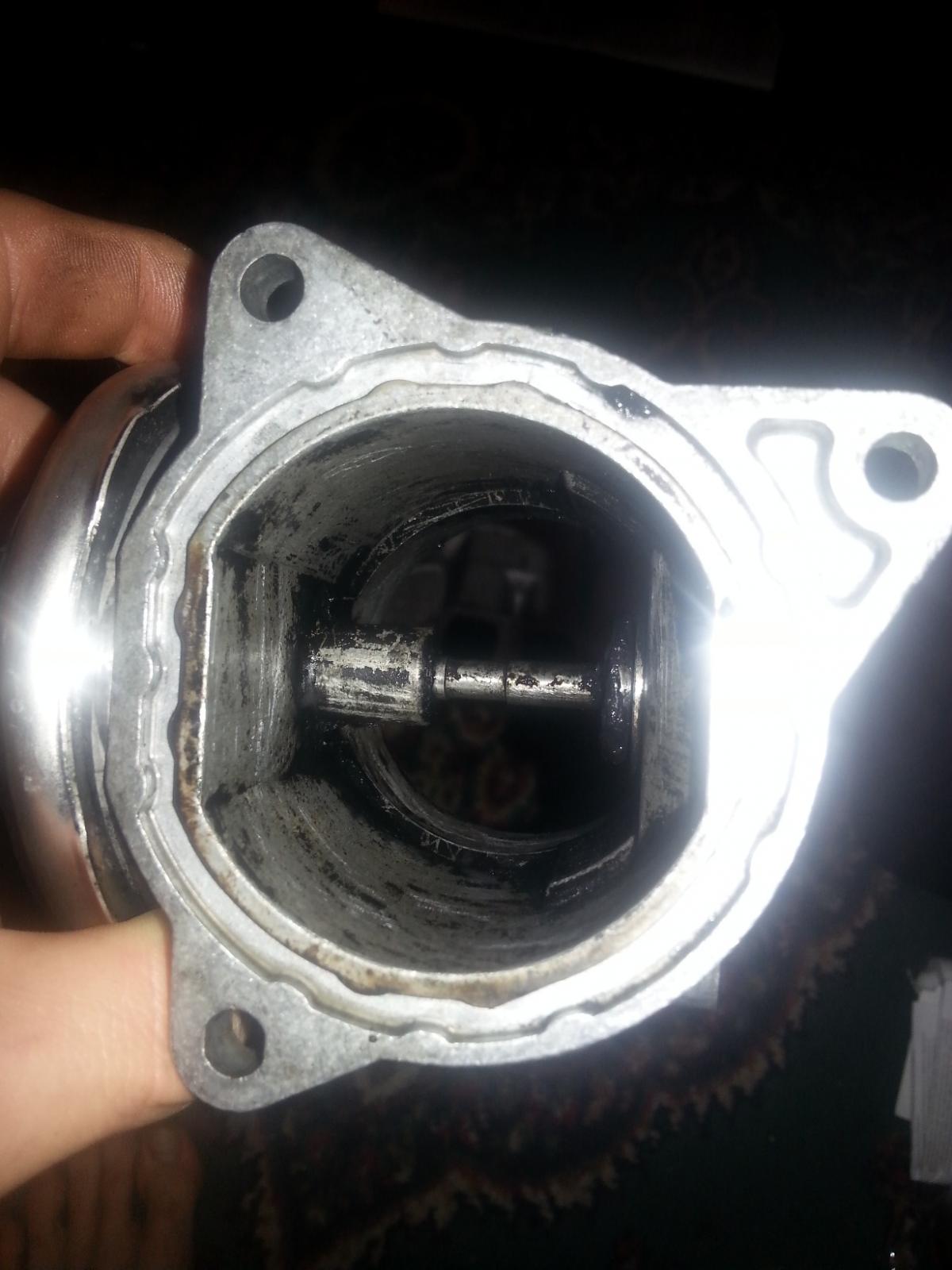

One of the egr cooler allen keys had been rounded in past .

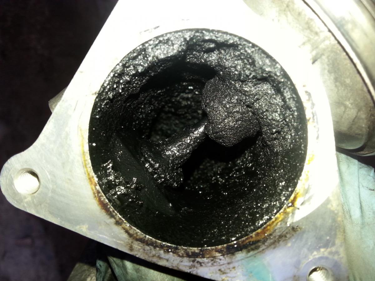

The amount of coke in the manifold was unreal!! Butter knife and gunk and toothbrush to clean it up

edit. Just remembered. . Upon rebuilding I noticed my egr to egr cooler pipe had split alil!! On Christmas day ... so had to improvise and make my own egr blanking plate and bolt straight onto exhaust. . Working upto now lol

You should have used caustic soda in your manifold mate, made mince meat of my carbon deposits. Not actual mince meat though, that'd be weird but delicious.

Quick think with a propper hot choc..
my left hand holds the actuator down out the way.. my left hand holds the bottom union with mole grips and my right hand works the spanner.
