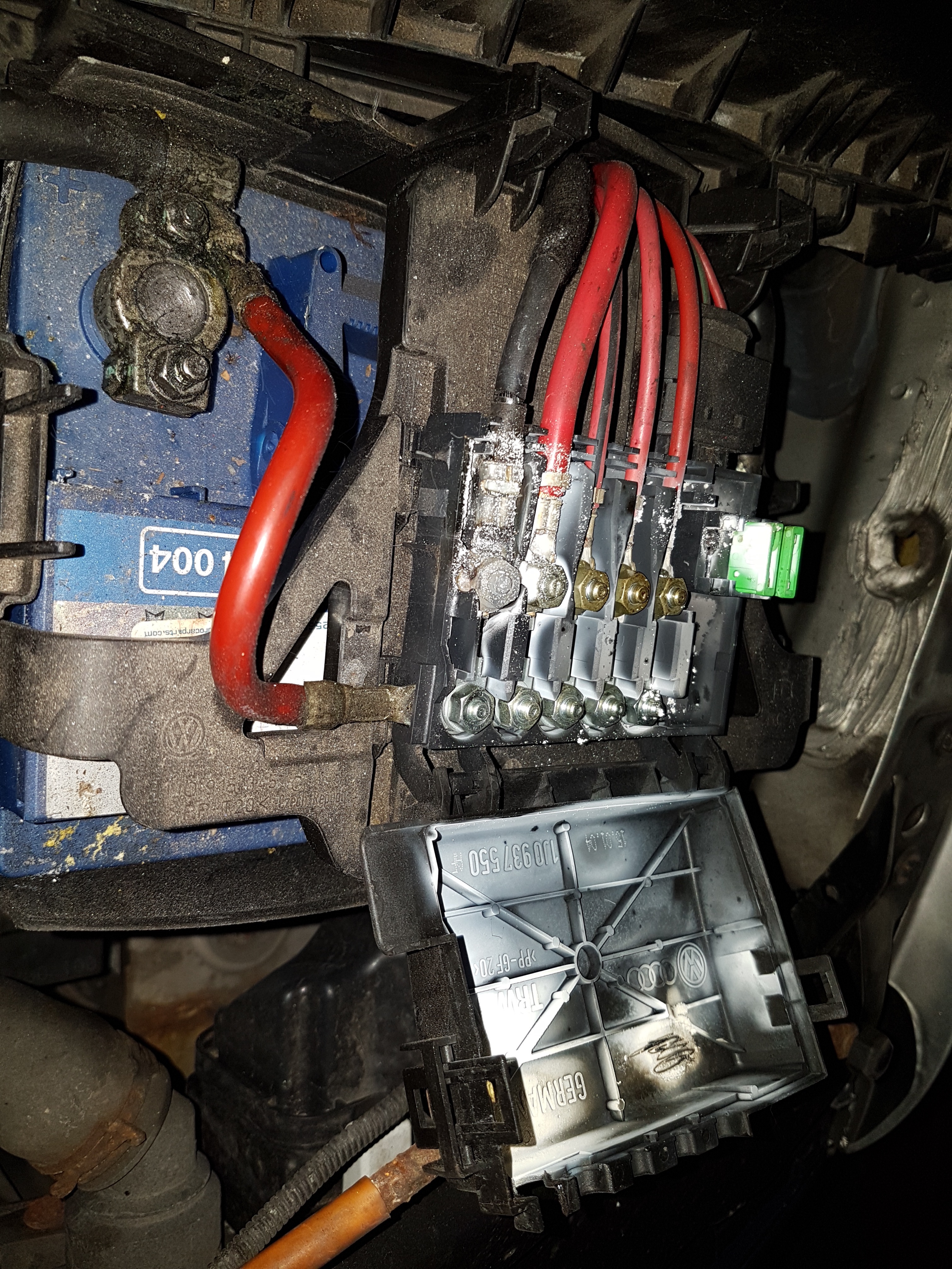

Not sure if anyone will still check this post but I have just had the same issue. Not too bad considering it's a 54 plate vRS which I've had since it was a year old! I've got a new fuse box arriving tomorrow but just wanted to ask if there's anything I need to do to avoid this happening again, other than making sure all the connections are tight?
Also as the one fuse is completely destroyed is it still safe to drive?

Which type has caused your issue?, do you have a picture at all?.
The cable part number is correct assuming you have climatronic. As to how hard it is to fit, not that hard, but access is not good in places if your car is in standard trim.

As you look from the front of the car it's the first fuse.
Also if you zoom in on the black cable there is a split in it, is this likely to be what's causing the issue?

It’s the blade fuse that has been damaged. Sod’s law I’ve got almost every other fuse apart from a 30Amp
That does not look good at all, the connection to the main alternator cable (the black one) looks quite nasty.
As the next stage of fuse box failure is total loss of power, I would suggest you don't drive it unless you really have to, and get a fuse box and cable on there as soon as is possible.
The blade fuse is likely a casualty of the fair amount of heat that has been going on there.
Did your climatronic work ok up to this point?.
Climatronic was working as normal although sometimes it would cool the car very well. Temperature gauge started creeping up while I was stuck in traffic on Saturday - that was the point I realised that neither of the fans were working.
I’ve got a new fuse box arriving today so I’ll order the alternator cable today as well, fingers crossed it doesn’t take too long to arrive.

I would not be driving the car with that as the next thing will happen is the heat generated through  that alt cable will be enough to melt itself completely off the fuse box and you have a live cable floating about in your engine bay . I have seen these arc on the bonnet and could start a fire.
once the alt cable has degenerated there is no turning back it will continue to allow resistance to built up at the crimp and make a huge heat build up at the fuse box.
