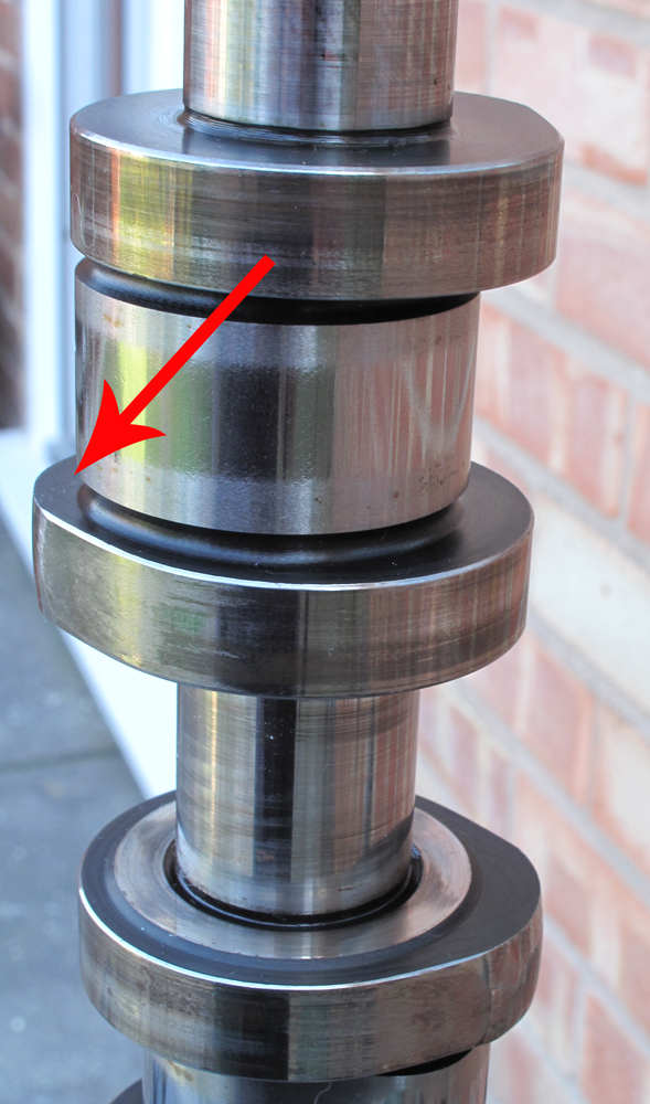

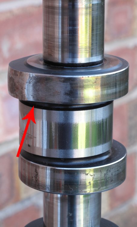

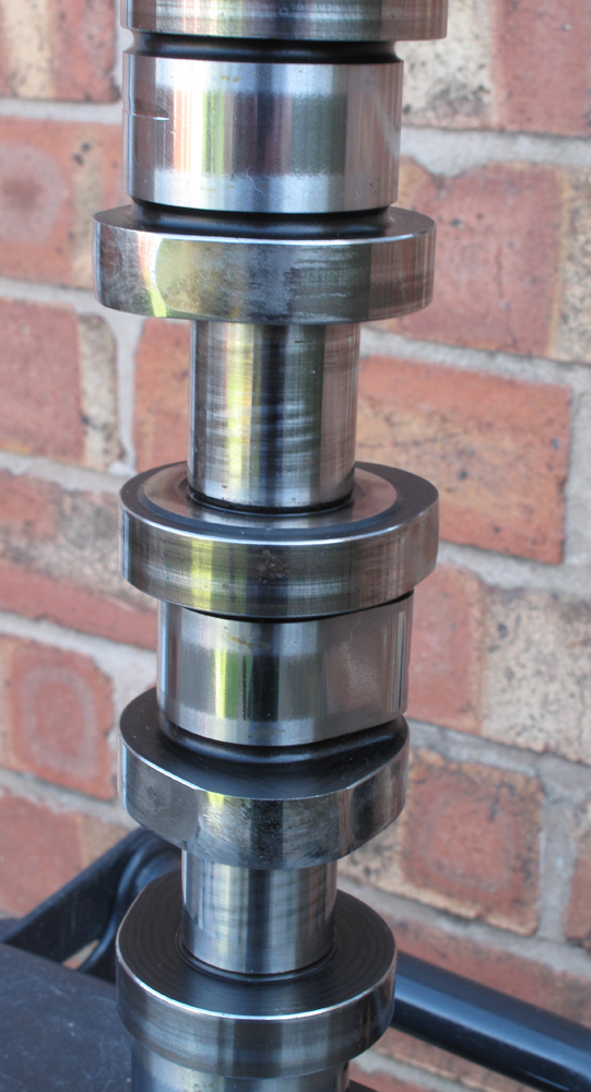

I have 2009 1.9PD PL Octavia estate, I had similar problem as you describle ie rough running under load and black smoke plus that it gave impression that there was more fuel being sucked in to the cylinders.
At idle there was no problems ticking over at 850/900rpm.
This is with a recondition engine which had done about 200000miles, original engine had done 1075000miles but it had to be scrap due to the crankshaft bearing shells breaking up.
I had Lion Garage, Leicester to replace camshaft, followers, rocker gasket. Total I paided was about £680.
The pictures show the damage of the camshaft.
