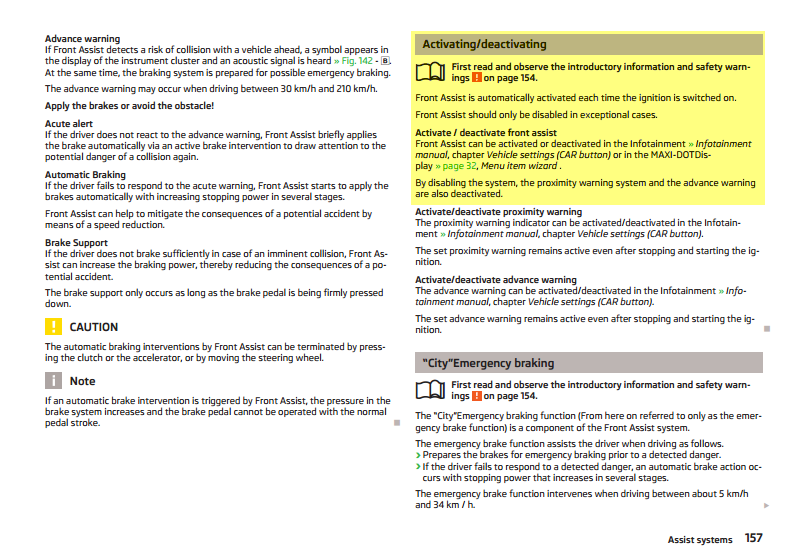

From my screenshot it should work between 5km/h and 34km/h.
