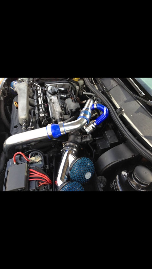

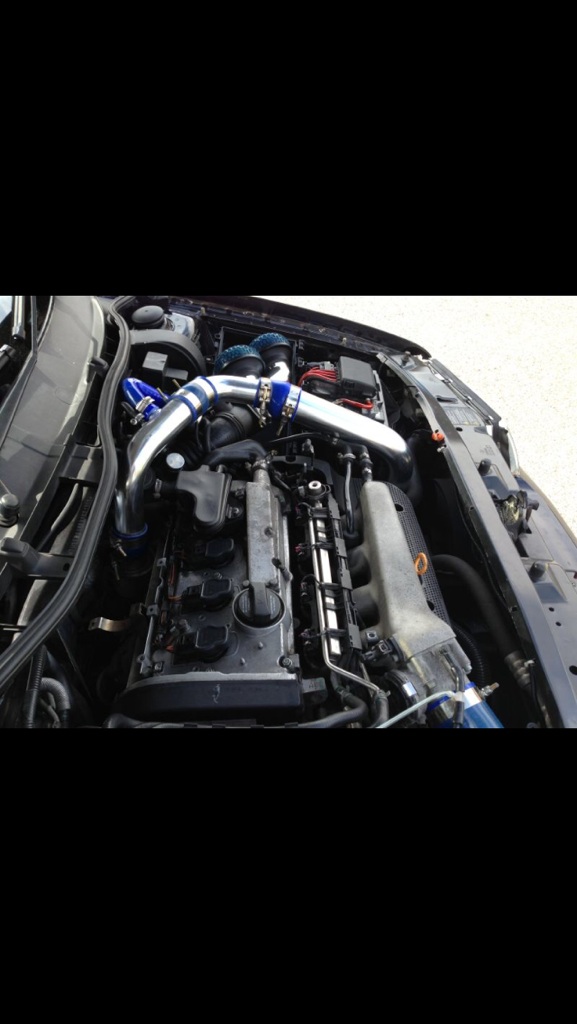

Well I have posted pics and the reg on the site but no one has really replied but al put some pics up on this thread see if anyone notices.well need to wait 3 week until I get my licence back before I can put it on the rollers to find out exact figures
post-110147-0-03736400-1384372853_thumb.jpgpost-110147-0-86331600-1384372878_thumb.jpgpost-110147-0-05611900-1384372909_thumb.jpg
Nice motor
Won't be 240bhp + with that setup
Intercooler top pipe to small
Has a 2.5 inch maf so must be a oem ko3s tip
So would indicate oem turbo fitted
Need to check see what you got first looks like a few cheap eBay mods
Car looks nice but don't think you got a stage 3 motor sorry

It's defo a toto sport intercooler he says it's running 16 psi of boost of that helps.and some sort of custom exhaust from tints n tweets which there's a recipe for £350 odds

Not sure the motors gonna appreciate that ext blow off valve? 1.8t need a re circ or it'll eventually throw up a CEL. If it's got a KO4 from a Bam engine it should have a EGT sensor port on the side of the turbos hot side.

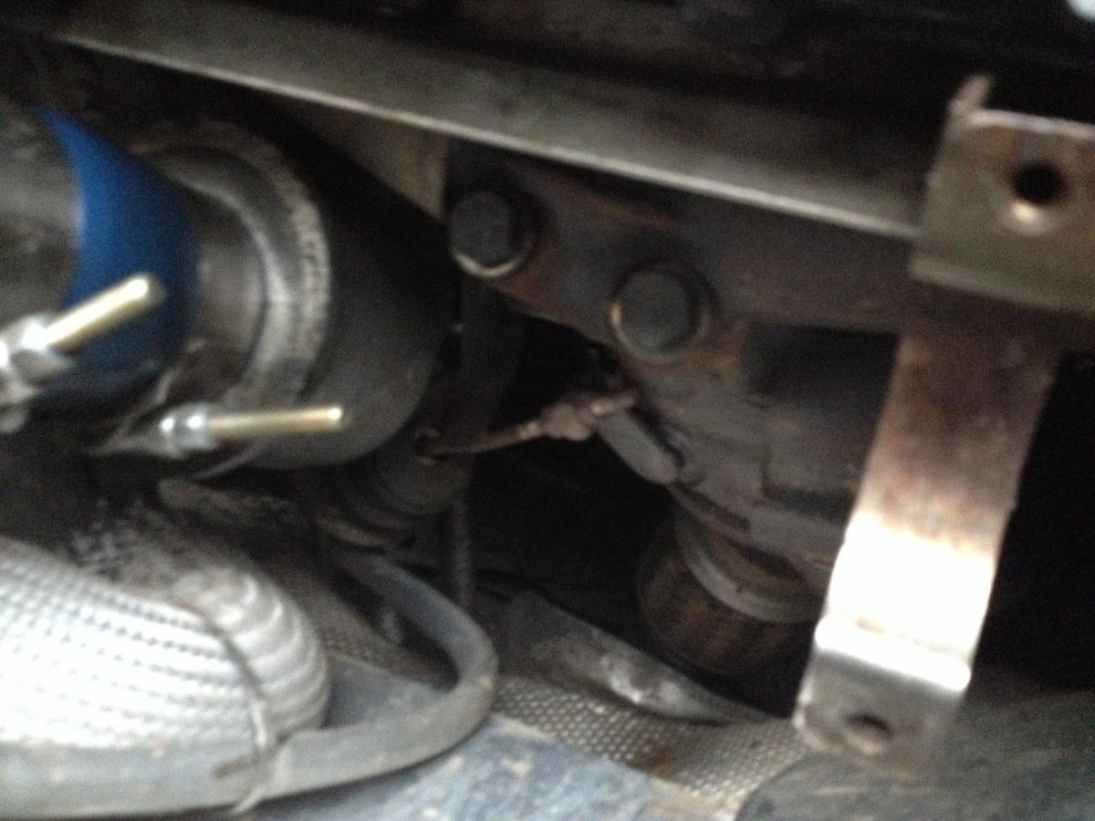

post-110147-0-76931500-1384536267_thumb.jpg Tryed to get a pic of the turbo but it's right at the back prob need to go underneath anyway can anyone tell me from this pic if the turbo looks like a standard turbo or a k04

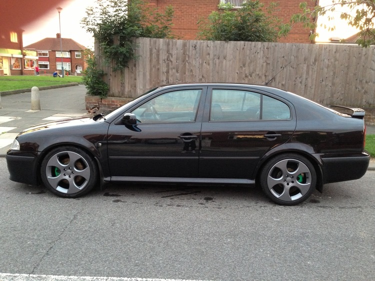

No idea on the technical questions Garyvrs13 I'm afraid but those Golf GTi alloys in grey really look the part on a black car.  Nice motor.
Yeah the alloys look real smart on it.someone on here must of owned it before me but just can't seem to find who lol.has a briskoda sticker on the back and a oh not another skoda one lol.
Really hard to tell which turbo from that picture. I could be wrong on this but I'm pretty sure that KO4s have the exhaust side (where the downpipe attaches to) opposite the intake at the other end of the shaft facing the drivers side wheel.
on a KO3/KO3s, the exhaust is at 90 degrees to the intake facing the ground.
From what I can see on your photo it looks like a KO3, but couldn't be sure.
from the back of the car to the front, after the flexi joint visible in the photo, does the exhaust go straight up to the turbo housing or around to the drivers side and then in?

Think KO4s are in the 8P S3 on wards as the Bam 1.8t use the KO4
Ko3s in the pic
Ko3s in the pic
+1
Looks like a K03s to me
Also that BOV and the twin air filter say previous owner added cheap mods and probably over exaggerated the power output and did not know enough of the car to be factual.
I would get rid of the BOV and fit a good known recirv DV that these motors need.  Other than that looks a really nice car buddy and wheel suit it. They look like MK 5 golf GTi ones. As others have said best get car checked to see what it is running as 16psi is defo not std but hard to tell what mapping,. Potentially points to a Stage 1 if it is on a Ko3s Turbo.
Looks like a bent actuator rod on the turbo also. Could just be the pic or my eyes though! Lol.
