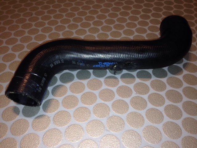

I have had my 07 Roomster TDi 1.4 80 for about six years now and it has been largely troublefree; mileage is low at under 40k. However, two months ago I had a breakdown where the bottom intercooler hose had perished. This was replaced along with a bracket; apparently the hoses are known to perish over time so I thought this was just something that happened due to the car's age.
However, last Sunday the exact same section of the intercooler hose blew again; I had only done a couple of hundred miles since it was replaced, and the garage is baffled as to why or how the exact same hose has been damaged so quickly.
The section of hose is the one that goes at low level behind the engine.
Has anyone had anything similar happen or can provide any suggestions; both the inconvenience and having to pay a hundred pounds each time is getting rather tedious as one can imagine.

Photos are attached.

In the first picture it looks like some sort of 'mechanical' damage - are there moving parts nearby that could have caused the damage?
As above,
the hose is rubbing on something to cause that damage
The mechanic who services my Roomster noticed the same hose was chaffing (not against any moving parts) at the last service, and protected it by cable-tying another piece of hose around it.  So it must be in close proximity to something down there.  I can't remember if a bracket had broken, or not.

As to what is causing the wear, neither myself nor the garage can think of the cause; I checked the hose after going on a 200 mile journey but it was still nice and smooth.
I attach another photo (this one is of the same hose before it was replaced for the first time).
I had exactly the same problem and the mechanic showed me the problem - the plastic bracket had simply broken causing the hose to rub against the engine. With hindsight I thought I'd heard a whinning noise. Interestingly enough mine is also a 1.4 tdi - wonder if it's the extra vibration from the three pot?
No problems since and that was over 6 mths ago.
