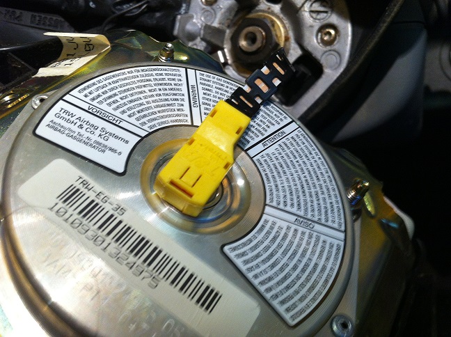

Ah pure poetry,   I am in the process of revamping my leather steering  wheel on my Fun, undid the two Allen screws, and out came the airbag,  it says in the manual undo the clip  but how   ime all thumbs when it comes to small electrical connectors  and I don't want to break it...........see picpost-103514-0-73162000-1385828019_thumb.jpg
It unplugs from behind the slip ring... That part stays attached.
Hi Tom   thanks for your reply,  Glad I came here before I broke it     is it  disconnected after the ring and steering wheel are half off?
