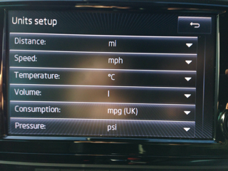

Not quite what I was asking, I enabled this on my car a couple of months ago and the display on mine showed the refuel quantity in gallons, not litres. I can't see a setting to change it anywhere either.
Sent from my phone so please excuse brevity and spelling
Andyvee the units menu has a volume option this is what changes the refuel quantity from gal to ltr but retains mpg as that's under the consumption option
