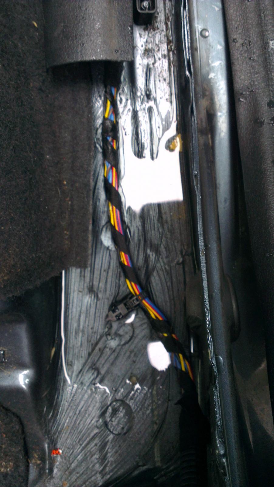

I removed some trim and found this lovely pool of water, inbetween the seat and door, above the foot well. This appears to be filling up then emptying into the foot well.
What I can't work out is where it is filling from. When I follow the bodywork up from this point it all looks dry.

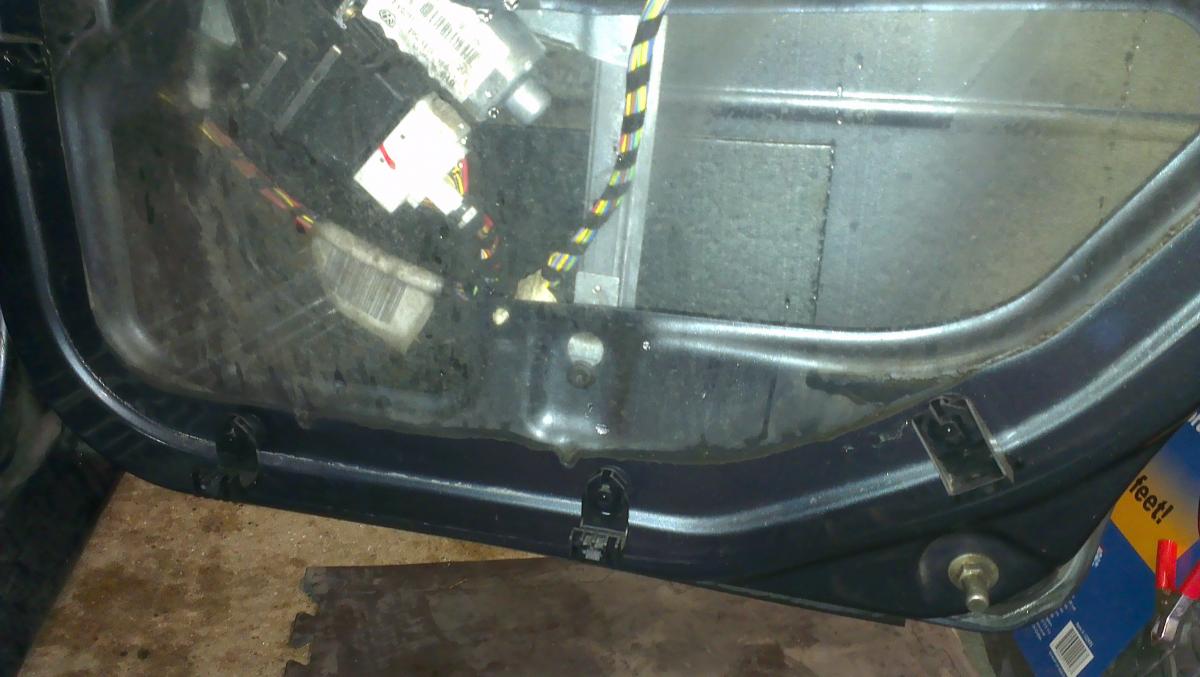

Whipped off the door card, and the membrane seems to be intact.
Haven't tried pouring water down though. Will do that now.
Right, poured a few pints over the exterior glass. Virtually nothing came down inside the door.
The few drips that did seem to be contained within the door fine.
Couldn't see any evidence of the seal being breached. :think:

As soon as we spray the sunroof it bloomin rains in through here at an alarming rate:
This is behind the rear seat, seems to be coming down the pillar!

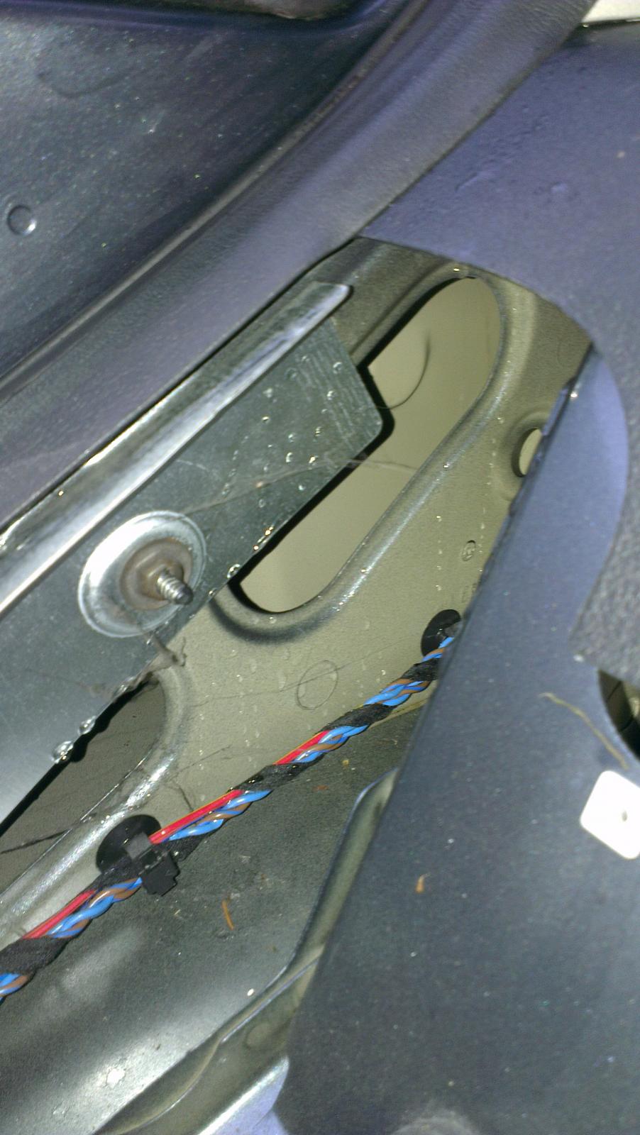

Stripped the trim so I could pull down the corner of the headlining.
I could then see the back corner drain for the sunroof. I doubt you could see it without loosening the headlining.
I sprayed some water on the sunroof and could see the drain tube dripping where the blue hose joins a white connector, which then connects the metal drain.
So I siliconed up this joint, then PTE, then some gaffer to be sure.
Then re-sprayed to find the joint being fixed, but water was now coming over the top of the drain, I felt around and there was a weird little nut in there, blocking it all up!
So joint resealed and nut removed, I dried everything and checked again, all sorted and draining nicely out of the wheel well.
