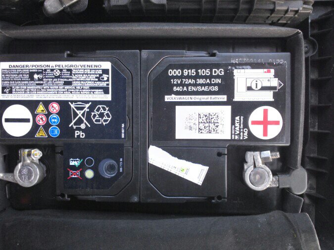

What is the Ah capacity and the CCA on your battery?
After Been told on five occasions that their was no probs with my electrics , then with my car not starting again over Xmas I have fitted a Bosch silver 5S008 77ah Battery at the moment its great ,starts every time with a minimum of cranks. I did post about this and my conclusion is although the tests states the Battery is good maybe, but in fact the Battery is NOT GOOD ENOUGH FOR THE JOB ON THE SUPERB
Just checked and the new battery is 72ah. Agree with mellyboy, much better now turning over with higher output battery.
Sent from my XT890 using Tapatalk
just been out and had a look at my battery on my superb (13plate elegance 170 4x4 estate) and it has a 340A 70aH battery fitted, Must admit if its been stood a few days it does struggle so will be finding out what it should have fitted tommorow.
The spec on my BOSCH  S5008 Battery is  12v capacity 77AH  CCA(EN)780 A
Thats far better as it is the CCA value which is the one to bear in mind during winter. Cold cranking amperes (CCA) is the amount of current a battery can provide at 0 °F (-18 °C)
