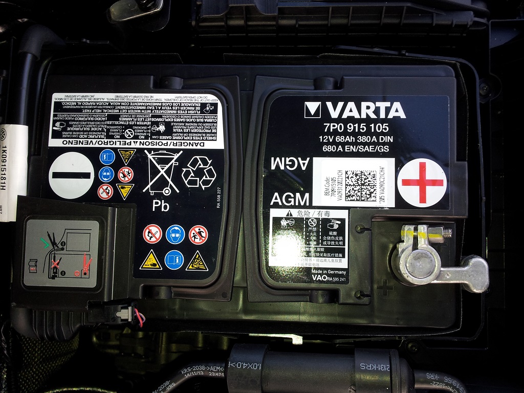

I wonder what the AH and CCA is on the FL version with stop start?
Here is a pic of 2014 FL model battery post-109690-0-09510700-1393506562_thumb.jpg
