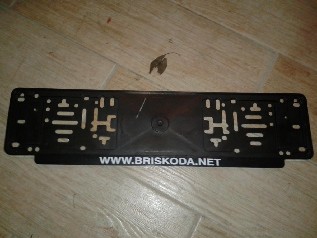

I think that part of the problem is that most UK plates are fitted without number plate surrounds/ holders that have multiple fixing areas. I'll have a look at SWMBO's later on and see how her front plate holder is fixed.
As shown in the pic, if you cant find a fixing on that that matches up to the pre drilled holes, you must be daft.
EDIT. That's not exactly the same type as the plate holder on SWMBO's which has a flap that locks the plate into the holder securely, but I hope you get the idea.
That makes sense Lee, perhaps  Skoda will fit them as standard, but I won't hold my breath.

OK, so it stopped raining for about three minutes today, just enough time to check how the plate holder had been attached. Guess what? Dumbassery and extraneous holes drilled, that's what :( You can see there are the original holes, with space to fix them on the holder but noooooooooo, the idiots only went and made four more bloody holes :wall:
