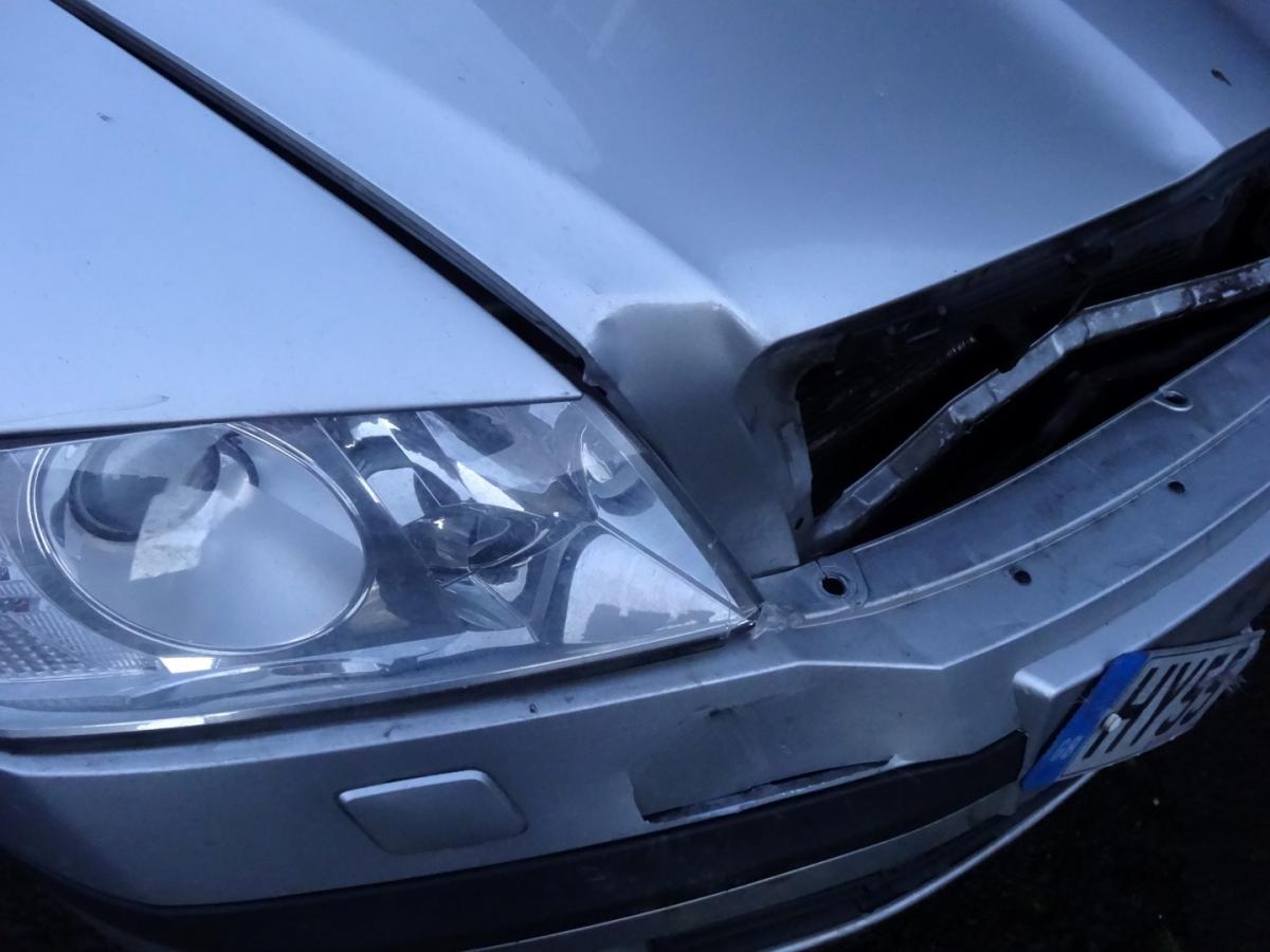

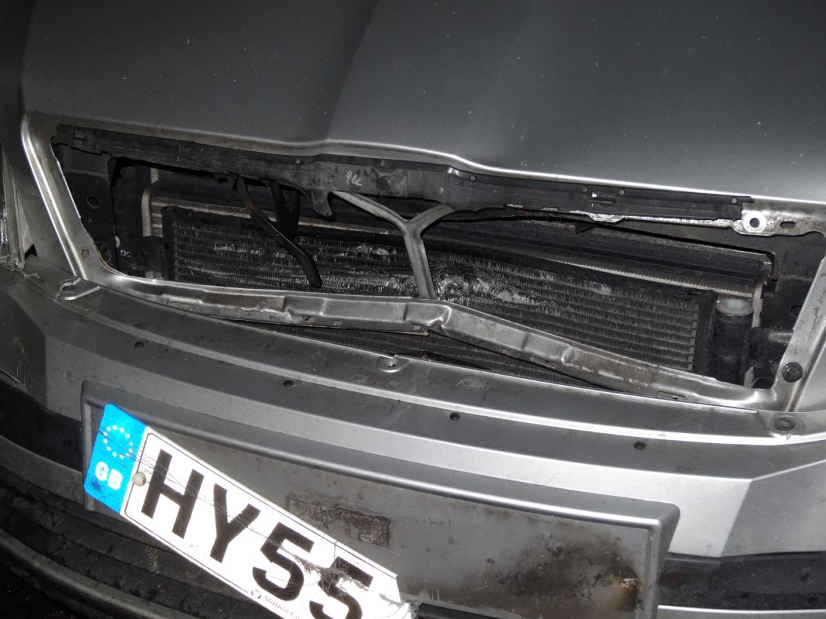

I've attached some picture's for more information.

the bumper, although damaged does still look serviceable and not in urgent  need of replacement.
I'd get, slam panel, bonnet, crash bar, AC radiator as a start and then dismantle the broken bits from the car and see how it shapes up. Headlights maybe ok, perhaps the brackets are broken but there is a repair kit available (at least there are for Audi lights). You could most likely source all these bits for slightly more than your insurance excess.

Totally agree. Would say it will cost you max £800 to buy it back after its been written off (and you had had your value payout). You know the car and the history of money spent so win win for you. Looking at about £300 for parts (a little more if the aircon rad and intercooler have had it) if you shop well on ebay. I wouldnt bother with getting a different colour bonnet as cost of painting it just isnt worth it. Wait for a silver one as plenty about and pay maybe £40 more then  a random coloured one. Bumper could easily be repaired but same again when considering cost of repair and repaint. Gimme a PM if you need any little front end bits as have some stuff lying about after my rebuild or if u want any info. Also if the aircon rad is ok then dont disconnect it and will save you the re-gasing charge.
Looking at those photos i would repair it myself and avoid insurance company.Theres lots of Octavias breaking on  ebay and could be lucky to get Silver panels too as its a popular colour.
