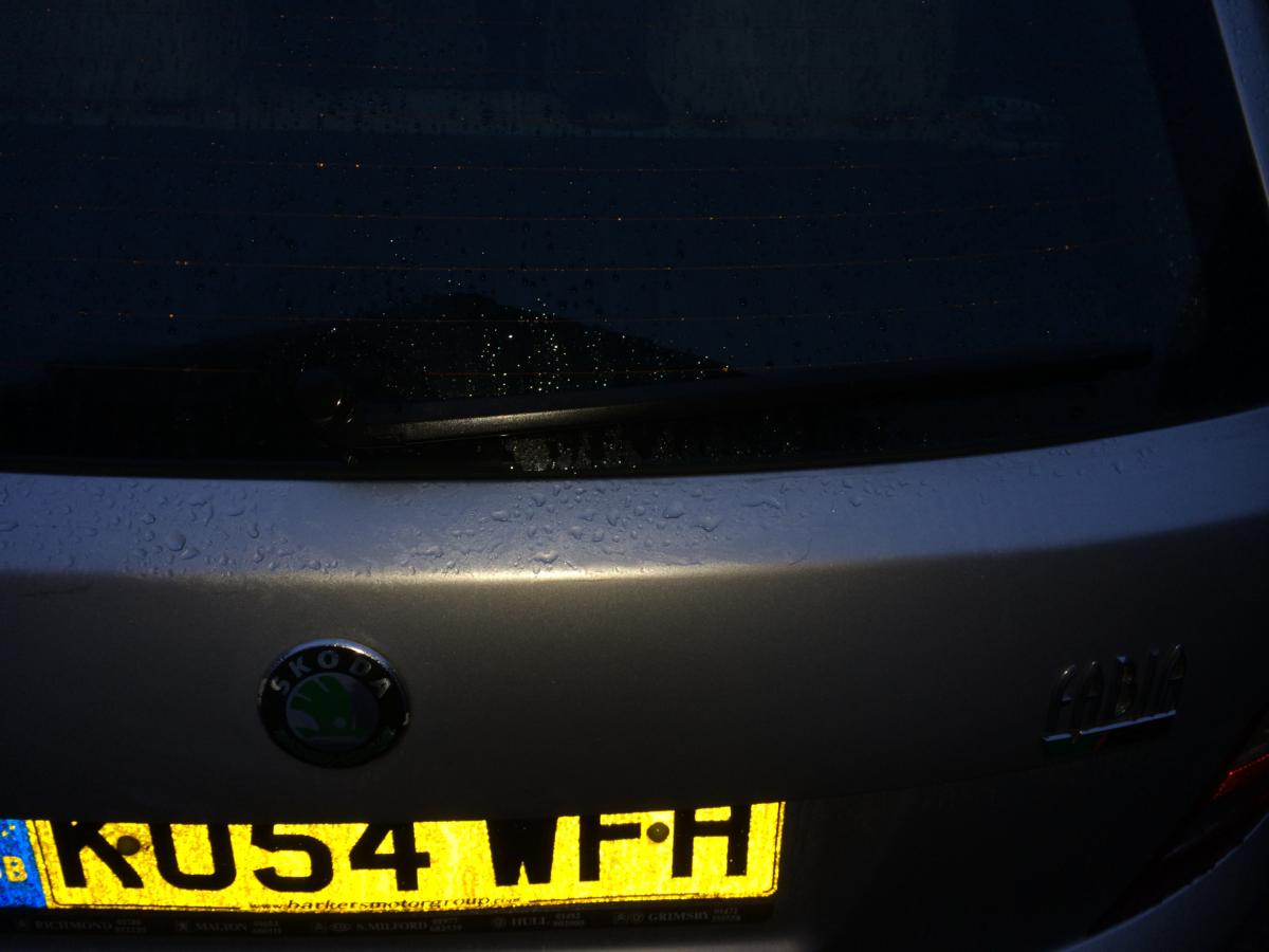

I've had my fabia nearly two years now. Just the other day my washer jet on the rear stopped working for the third time in my ownership. I'm guessing its probably the bulkhead connection again as it has been on the previous occasions
Is this a vRS rear wiper ?
can't really tell, do they have 'daylight' up north :D There in no speshul 'vRS' wiper, they are all the same.
