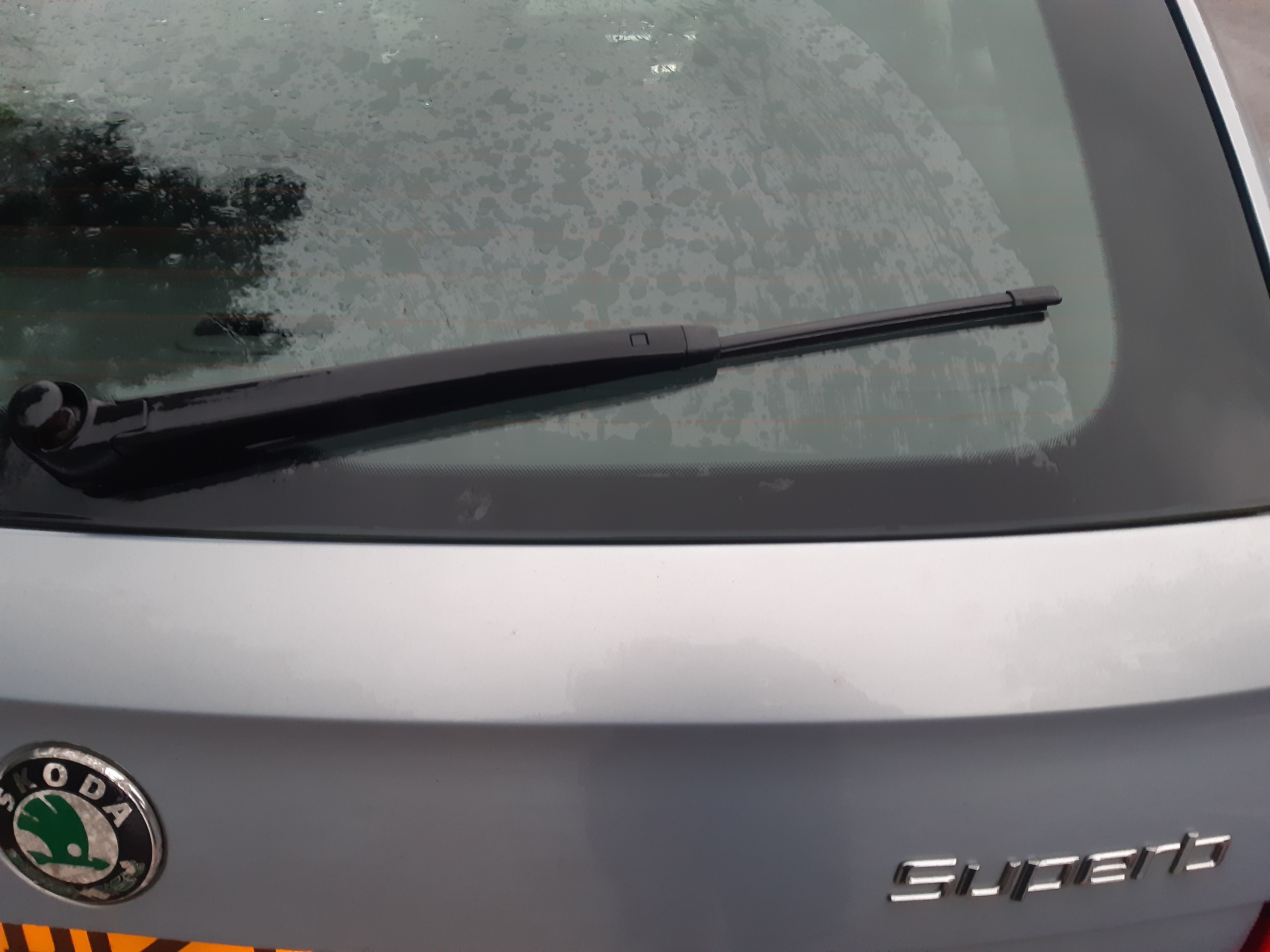

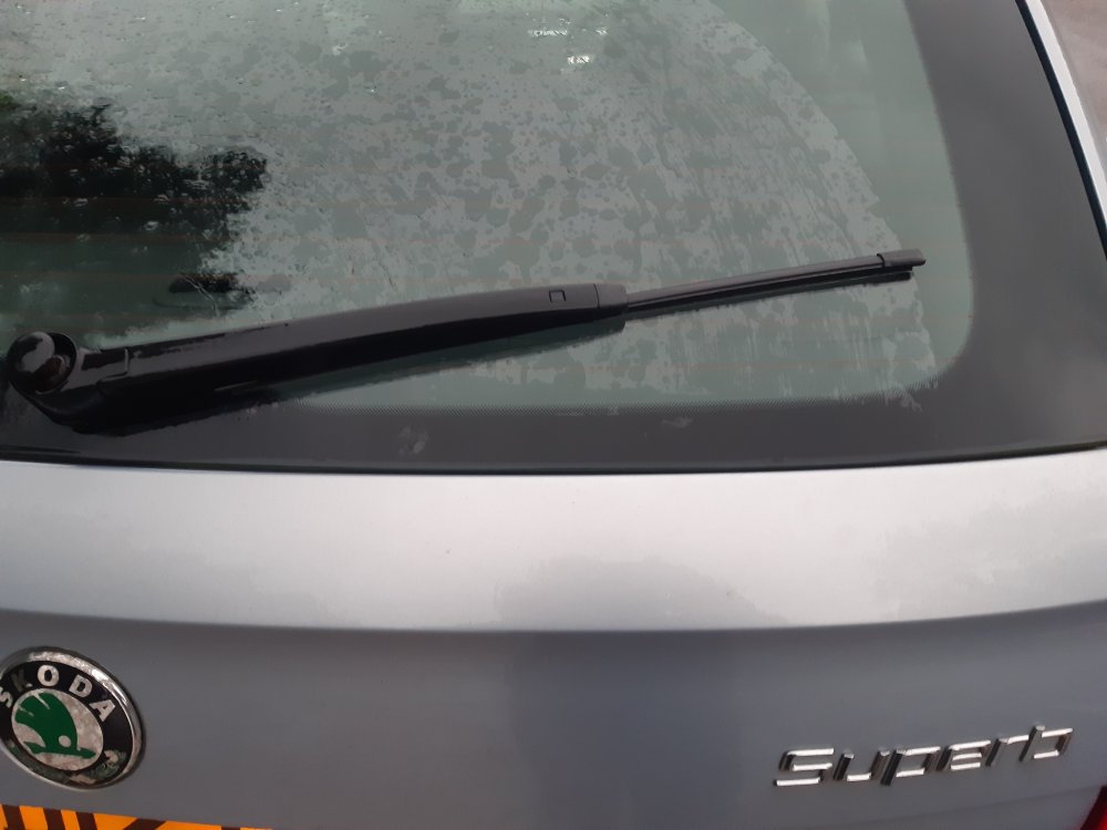

Yes you are correct the problem is caused when the rear wiper isn't parked correctly!  More often than not the rear wiper bounces back up from the park position as in the the photo and then the rear wiper always activates when I start the engine!

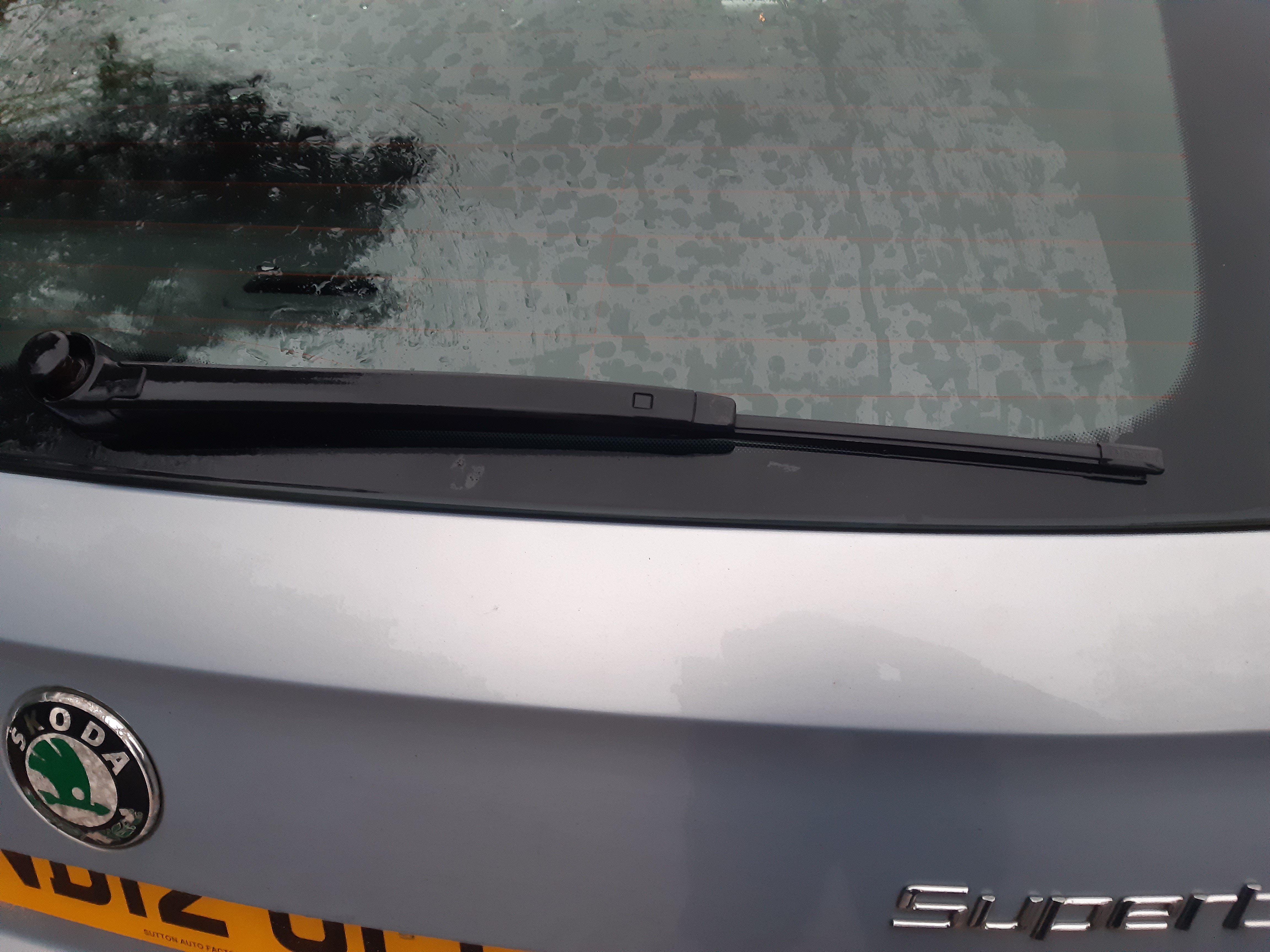

Very occasionally the rear wiper stops where it should! As in the second photo. When my rear wiper stops in this position then it never activates when I start the engine.
It is a bit hit and miss but you can force the rear wiper to park correctly by putting the rear wiper switch on with the ignition on and just before the wiper reaches the bottom of it's stroke turning the ignition off and stopping the rear wiper. Then turn the rear wiper switch off.
I've just learned to live with it and avoid using the rear wiper when it's parked correctly.
IMHO the issue is with the rear wiper motor. Maybe there is something that can be done to the rear wiper motor to correct the problem? I thought that maybe it could be down to wear in the drive gears causing backlash. But I can't get my  wiper arm to move in either direction when I try to move it by hand. So it must be something to do with the self park mechanism in the motor housing?

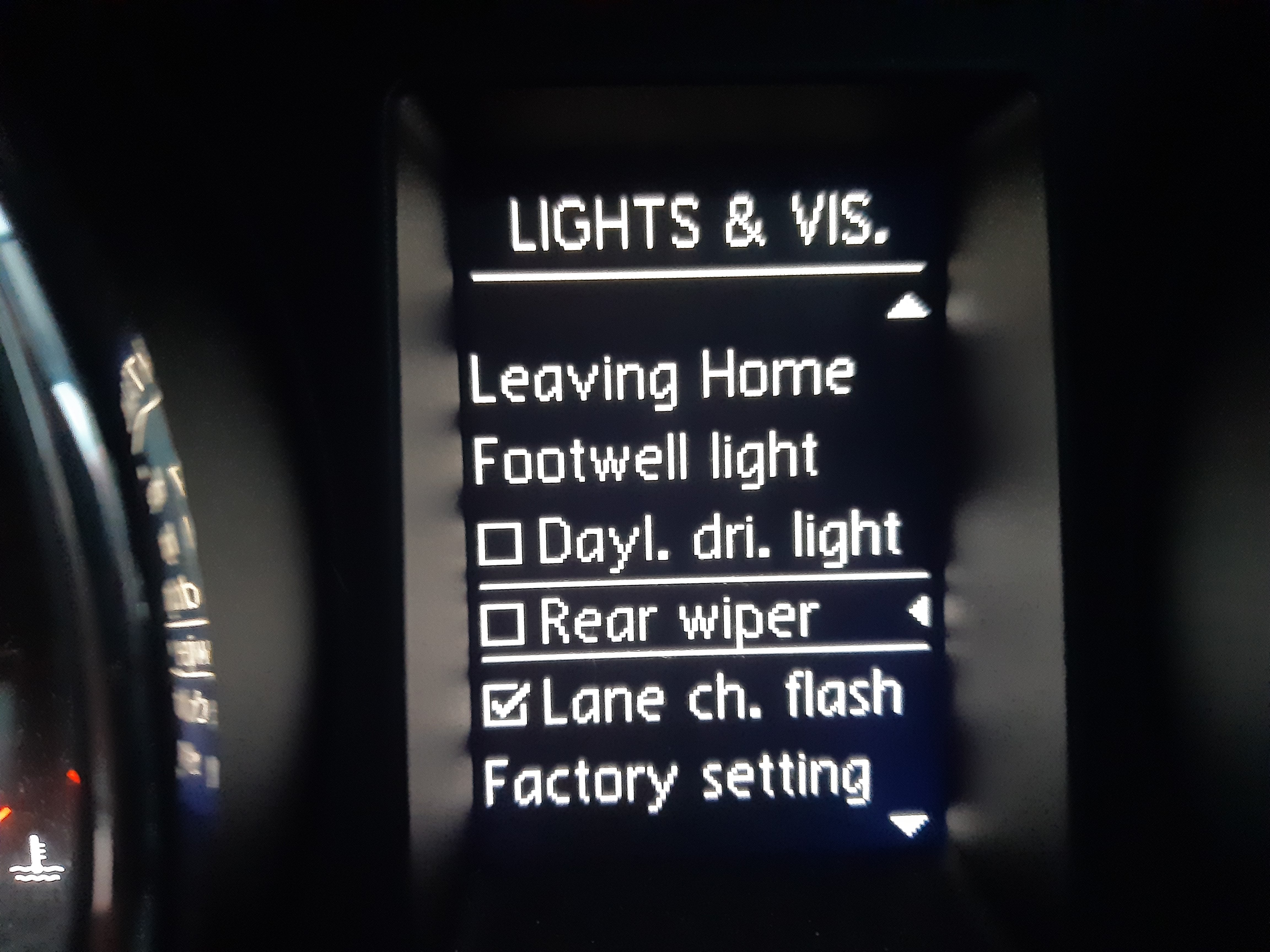

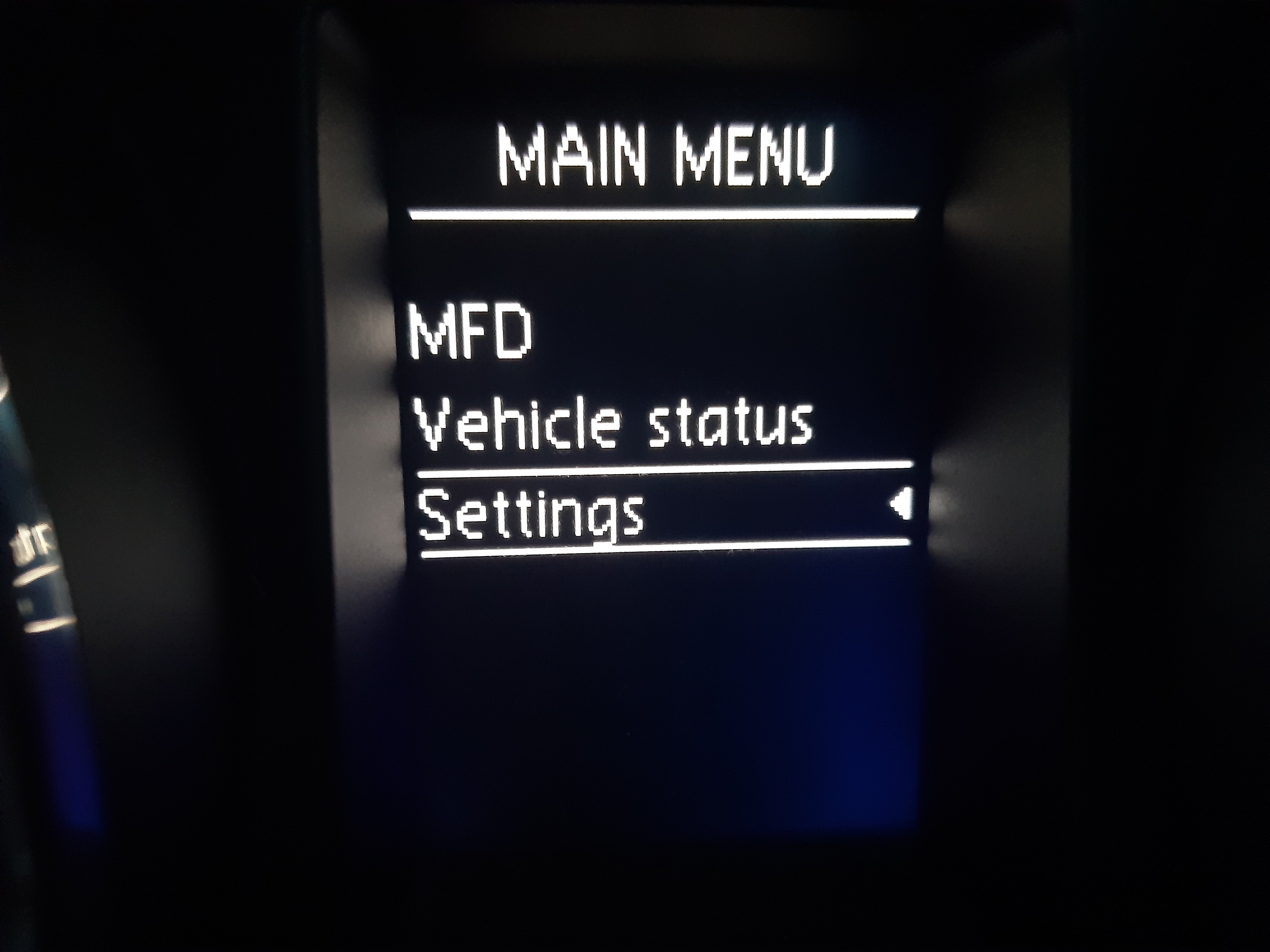

There seems to be some misconception by some people what the Maxidot screen rear wiper function is for. It's not for disabling or  turning the rear wiper off.
When the rear wiper function is selected when the front wipers are working and you select reverse the rear wiper turns on for one wipe.
It makes sense really, you're in a busy car park and it's tipping it down with rain the front wipers are working you select reverse gear and then realise the rear visibility isn't great ! To save you the inconvenience of faffing around and turning the rear wiper on it's already done it :-)
