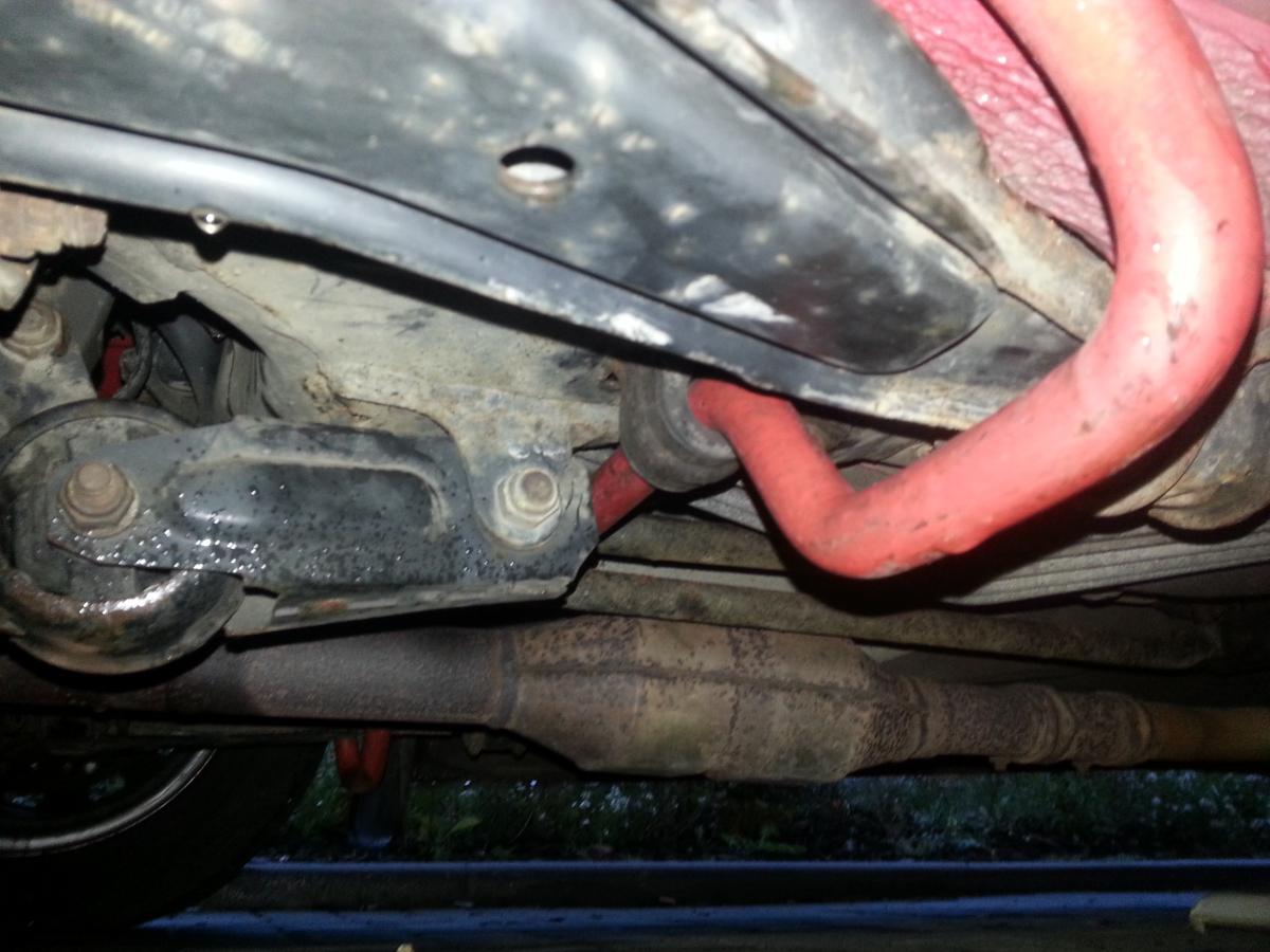

Yeah the most important ones are the ones on the subframe, it's like a thin slot and just in front of it is a captive nut type fitting which is tapped, I'll see if I can't find a picture.
Not a good pic but there all there on the felicia x member
I hope these help.
