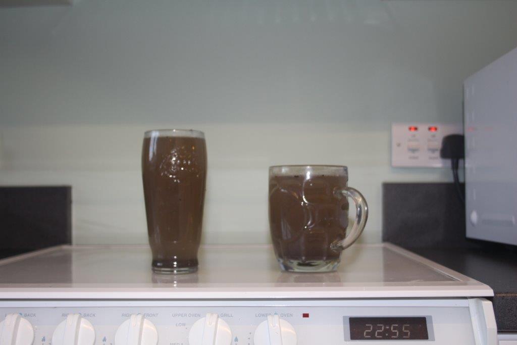

This is the amount of water collected in one footwell before I sealed to door carrier.
Didn't help the car standing for two weeks.
