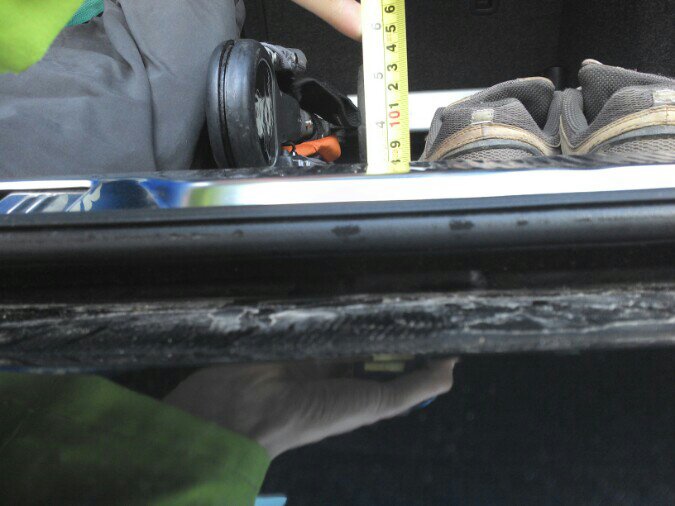

It's flat, no boot lip.
80mm from the standard boot floor to the top of the lip.

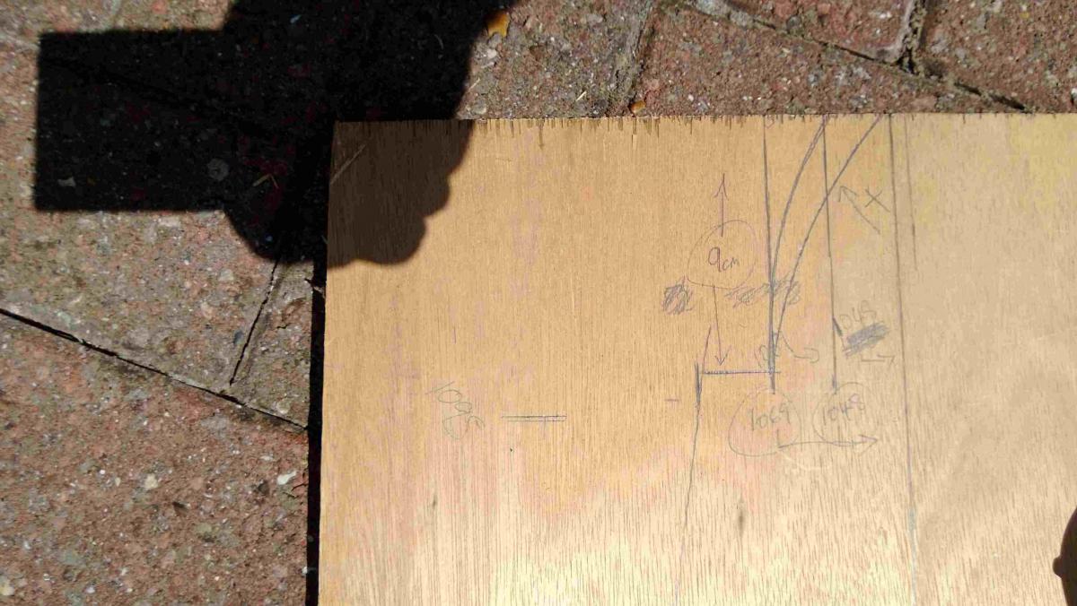

This one shows the shape to cut at the boot door end. 1049 and 1068 from the seat end
overall depth of the wood not shown on this pic.

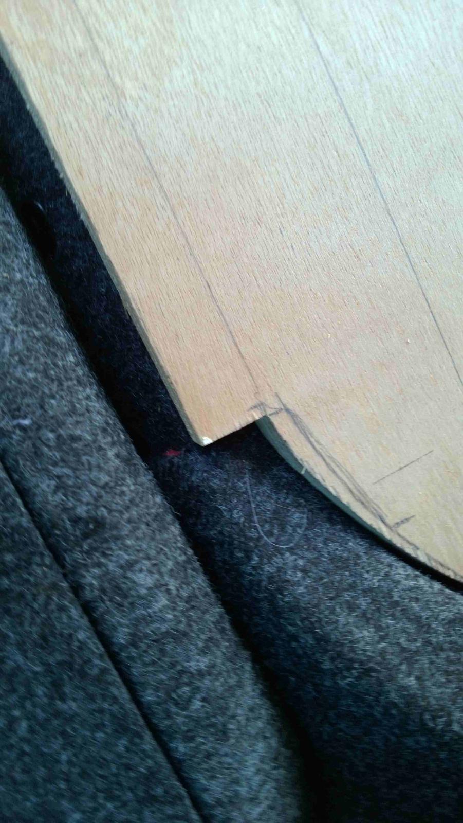

The following picture is the shape to cut at both corners where the wood touches the rear seats, this pic gives away the transition measurement missing from above (2cm)
clearly the wood is at maximum width in this shot (max width to be identified later)
Again I see a vital third measurement missing but may be on a later pic or I can measure.

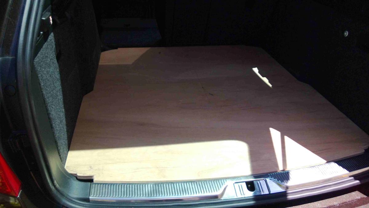

And here is that shape cut and sat (rear seats folded down,

Here is the final cut in place (shame about the sun.
Here the final pic shows the addition of nail in felt furniture feet and a 1cm tall piece of stripwood on the rear seat end which brought the whole floor up to the boot loading height and I thought would also prevent any squeeking of wood on plastic.

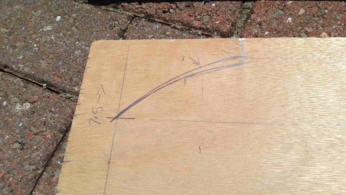

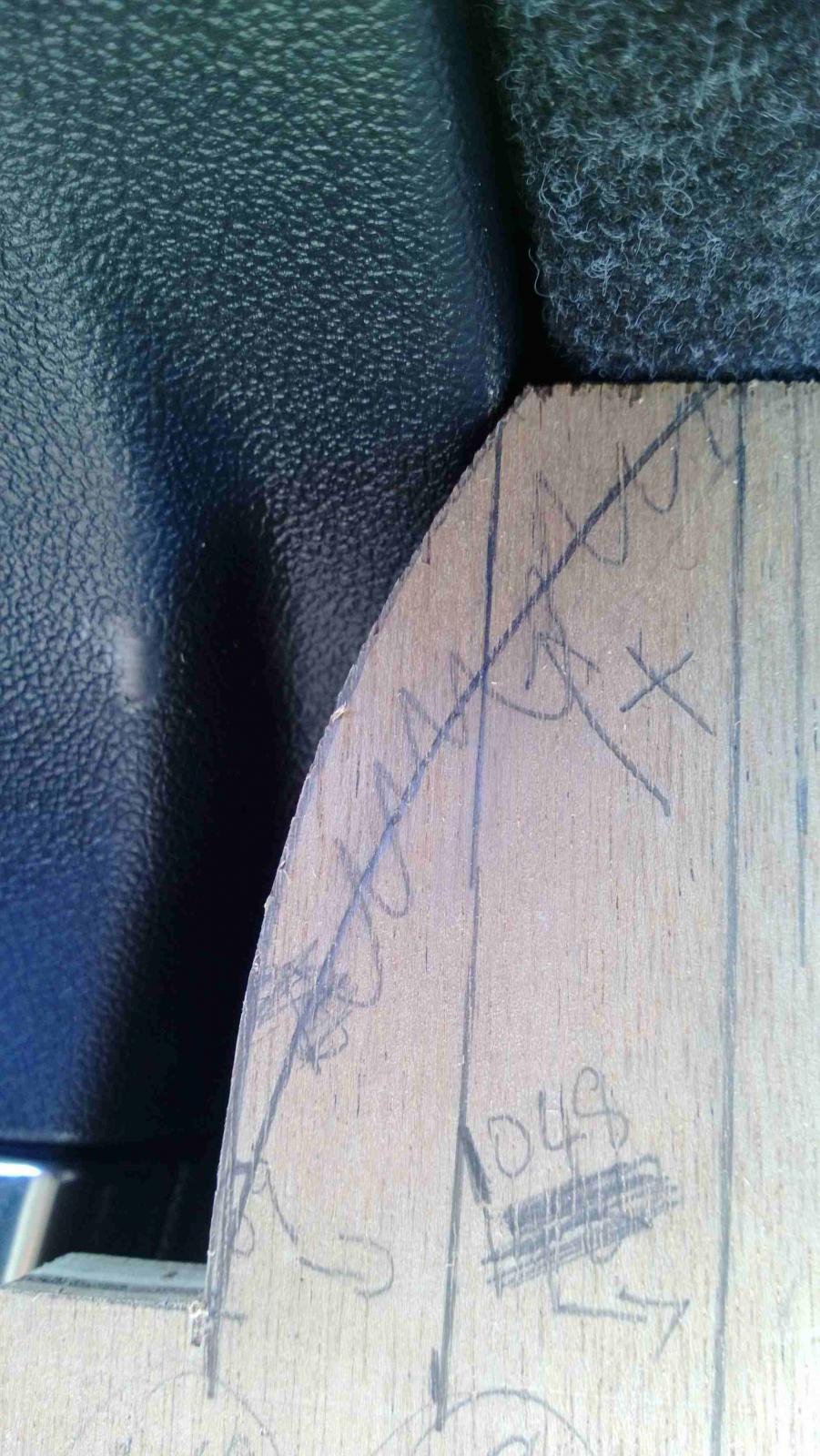

So I think we are still missing the overall depth of wood needed and also the arc shape at the boot door end.
you can see the arc on this following picture but I do not see the dimension marked.
If anyone wants more dimensions I will measure next none rainy day and post.
