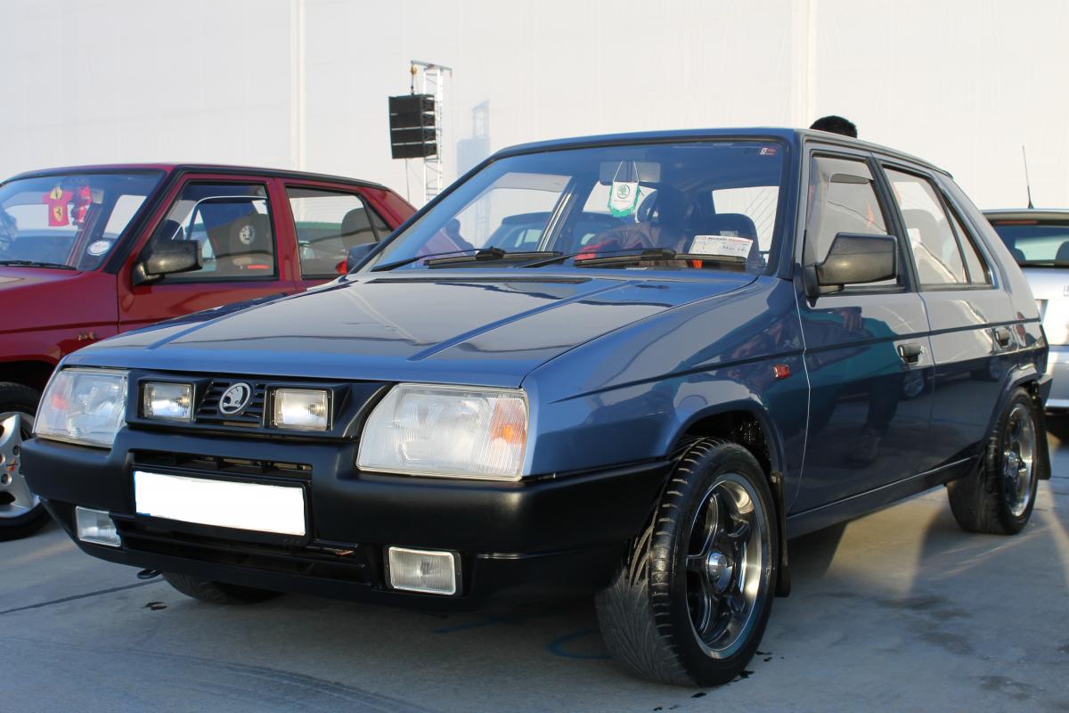

Thanks for your replies, did think about lowering springs but thought i might as well replace the whole lot whilst I'm at it, and If I wanted to drop it lower then I'd need coilovers, warbuli have you got a picture of what it looks like lowered by 40mm? Cheers
 yes i have  here  it is :
It might not look like much but it definitely looks way better.
The only problem that i seem to remember having is that the rear tyres used to rub with the wheel arch lip but i rolled them and the problem stopped
Skodanormal yes that's the exact car I have!
Warbuli that looks smart might just go for the lowering springs then it's a cheaper alternative!
Thanks well the only thing that might bother you a little, is the fact that in the front it doesn't look lowered when compared to the rear of the car because the wheel arch is higher in the front then in the rear. you can clearly see it in the pic i posted.
