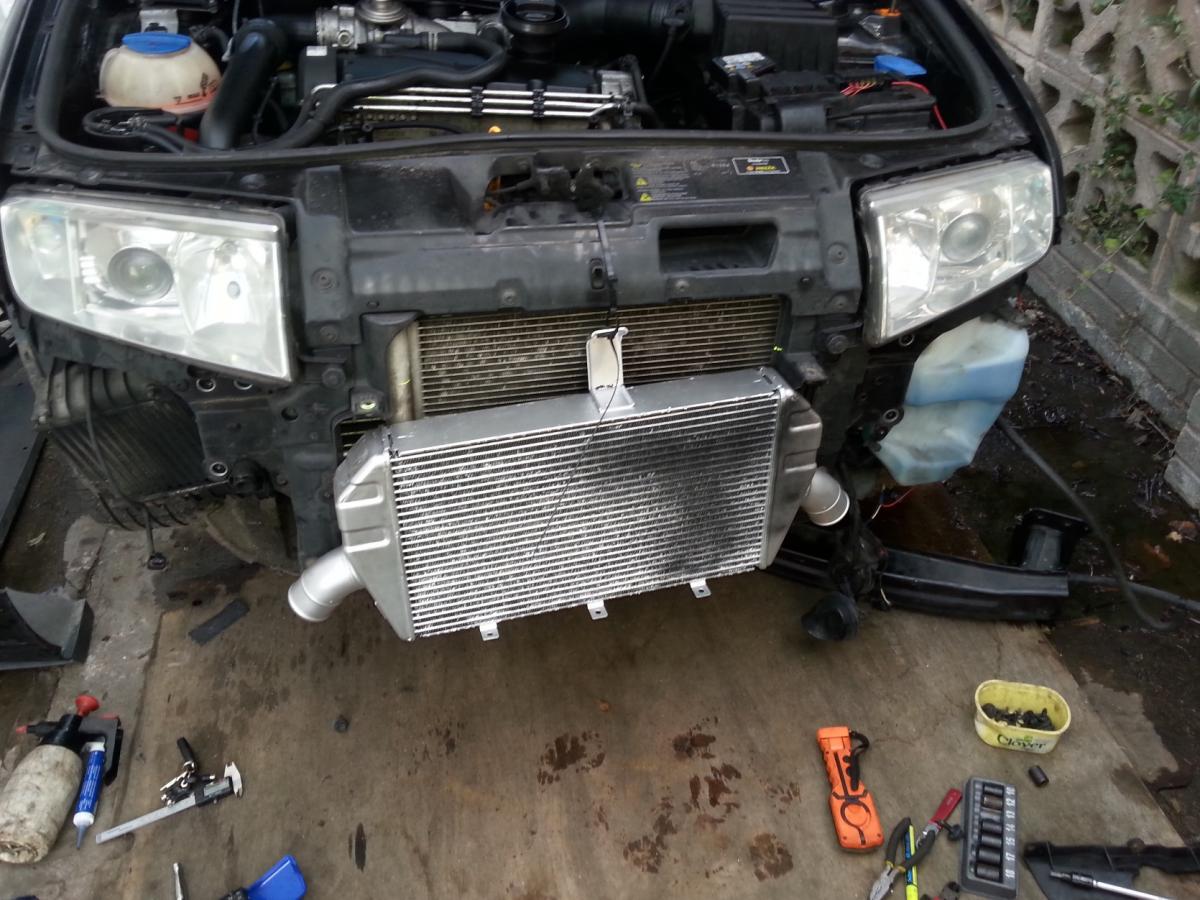

If it wad a inch short or inch narrower or inch thinner it would have fitted nicely.
But I think ita just that bit big. As the piping will need the bumper cutting. And I dont fancy that.
Ill need to cut the crashbar to. But I can soon replate that and weld strength back into it

  • Realise this. The more pipework. The more air needed to fill and more lag. Just trying to work out if I can fit this cooler into the space and how to best run pipes before I go spending any money

Im in a half mind to buy the 90 degree elbow reducer toput on the ns and see if it will lign up wirh the pass through or not. Or just put it for sale and look for a slightly smaller one lol
Doesn't look like much work - run it on the passenger side the same way Joe has done his ;)
That was my plan. But think its too big. Might have a think on it for couple of weeks and save some money up lol
Well. Tomorrow im gonna making my cooler fit. Its gonna be tight haha

im not quitting. Just having a step away and think ;)
It will fit m8.. i had to modify the back of my bumper + lost the drivers fog light but you cant see any of the modified bits once its on + i just mounted my short private plate over the drivers fog surround lol so no1 can even tell lol :)
On seat sport style ones theres still cutting of the bumper involved and other stuff on some kits so its not out of the ordinary to start chopping stuff up.

ebay m8. Its a Toyosport cooler i cant remember the size but it was the biggest one with 57mm outlets..

Ive dicided.... im gonna do it and make it fit!
Gonna work out what size piping im gonna run.
maybe 57mm from egr to cooler and maybe 51mm from turbo to cooler. Going off of the coupler sizes.

62cm Wide End To End
23cm High
6.5cm Thick
57mm (2.25") Pipe Inlets/Outlets

Had a quick look on the bay + im pretty sure it was this size
23cm High
6.5cm Thick

I kept my A/C and modified the back of my bumper but you would have more room without the A/C

Think im gonna adapt front crash bar.
Alter inside of bumper (cut them blocks behind number plate back)
Space out my modified crash bar.
then get a sledgehammer amd gently mount cooler.

You can move your rad and ac rad back abit so I have been told.
Oooo can you... how roughly . Moving tje drivers side of rad back would help allot
