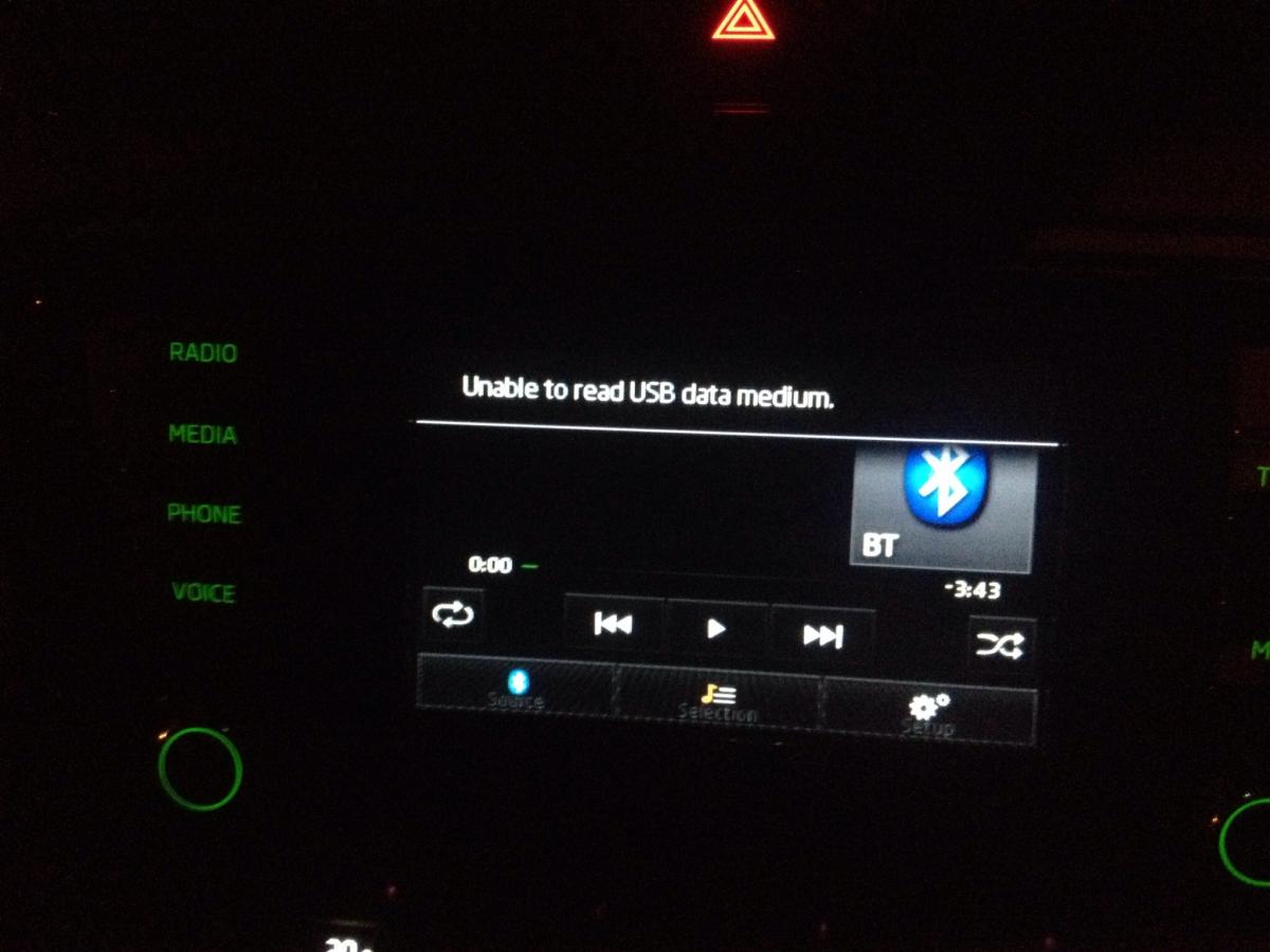

I have a two month old vrs and prior to this I had a superb, in the superb I played my music via an external hard drive and by using the MDI cable. I started using the same hard drive in the vrs by plugging it directly into the USB port. The hard drive developed a fault so I purchased a new one, however, when I plugged the new one in i get the message contained in the photograph. I tried another hard drive and that wasn't even recognised at all. I spoke to Skoda Customer services and their technical team advised that hard drives cannot be used in this way despite me doing it previously and the instructions saying that you can !!

Hi,
I can think of two possible problems which can prevent you from accessing the music on your hard drive:
- not all USB ports can provide sufficient power to spin a hard drive properly. It is possible that your old drive required less power to operate. Ususally if the hard disk doesn't get enough power, you can hear strange sounds comming from it (like the disk is trying to spin up and failing). Unfortunately if this is the case, there is not much you can do, other than buying a new disk and hoping it works.
- the new disk might be formatted with an incompatible file system. I am pretty sure that the stereo supports only FAT32, so if your hard drive is formatted with NTFS, you won't be able to access it. In that case you can simply format the disk with FAT32. Be careful, all data on the disk will be destroyed during the format!
