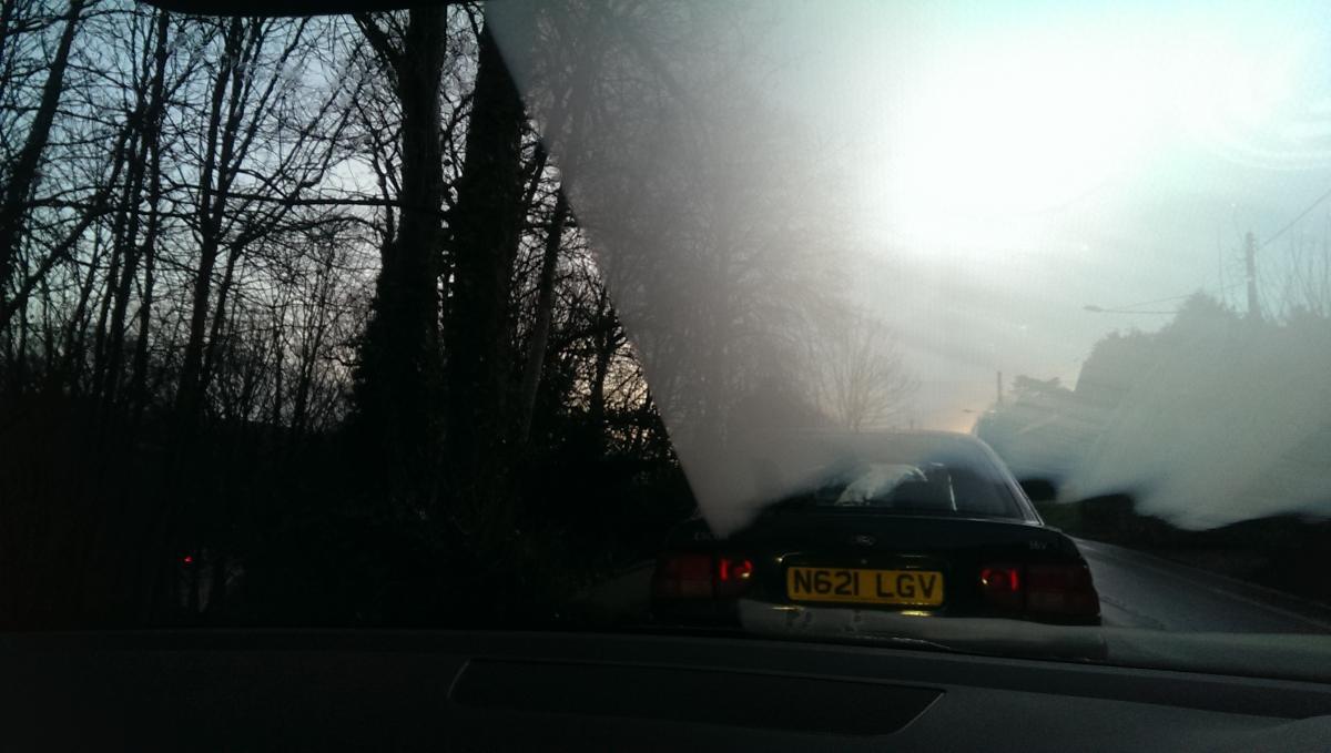

So this morning hit Max demist button (always does the trick) and this happens. Didn't get a picture, but initially got a PERFECT 50%:50% split between demisted screen and misty. Looked as though the heated screen was kaput, until I realised it wasn't switched on! I guess the car can intelligently switch air around the car (although not move vents like some can). Hit the heated screen and was gone in seconds!
See pic attached:

Great. Checked screen this am and only the left hand side gets warm with heated screen on. :(
Looks like a duff screen to me :(
Yup. Off to the dealer next week then I guess.

Title edited for you, its either a failed screen or a dodgy wiring connection. From what I recall both halves are heated via separate feeds.

The heated screen is 2 elements as previously stated.
Both are powered at the same time but if you have an issue with one side then the other still works (as you are experiencing)

I'd have to say that achieving that kind of clear separation between one side and the other just through directing airflow would have been impressive.
