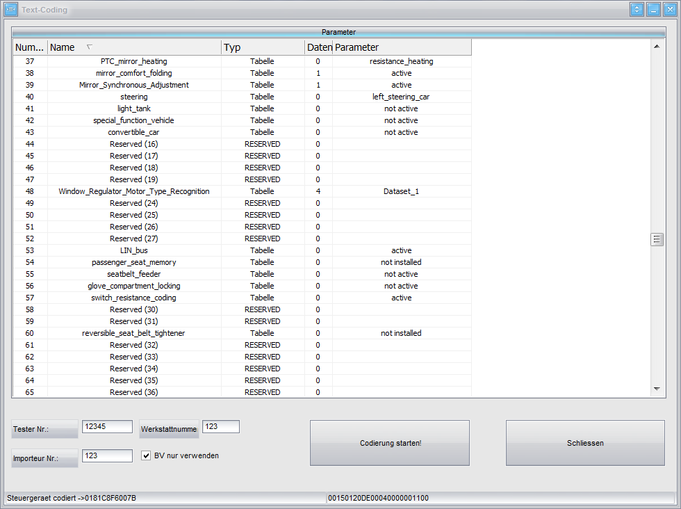

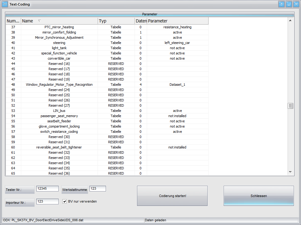

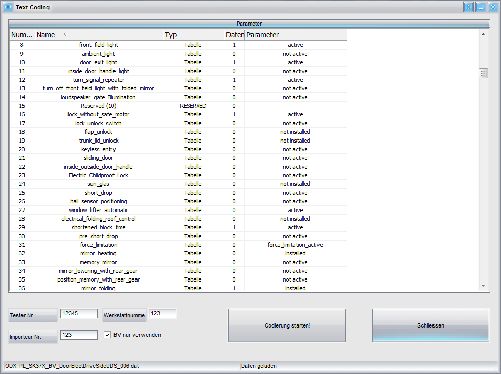

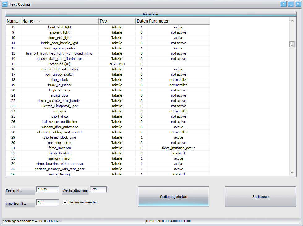

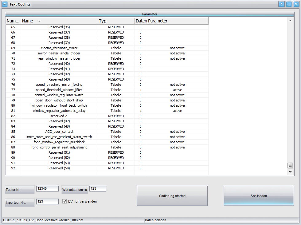

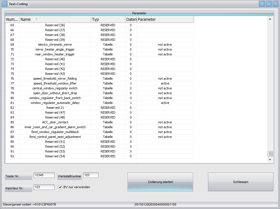

Here is my coding of O3 BW >45post-110330-0-38446100-1393956695_thumb.pngpost-110330-0-87258100-1393956700_thumb.pngpost-110330-0-26270800-1393956707_thumb.pngpost-110330-0-55189700-1393956713_thumb.pngpost-110330-0-10892200-1393956722_thumb.pngpost-110330-0-37406000-1393956734_thumb.png

Yes correct. It is a screenshot of VCP-Pro.
The first three is driver door, the second three passenger door. Both startet with row 8. 1-7 is reserved.
