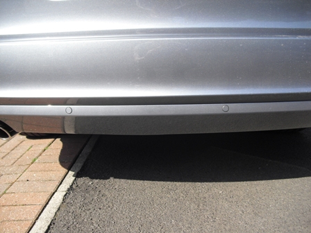

What ramifications are there in having the rear sensors?  I have used towsure in the past who have been excellent but any advice or links from people who have done this would be much appreciated.

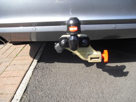

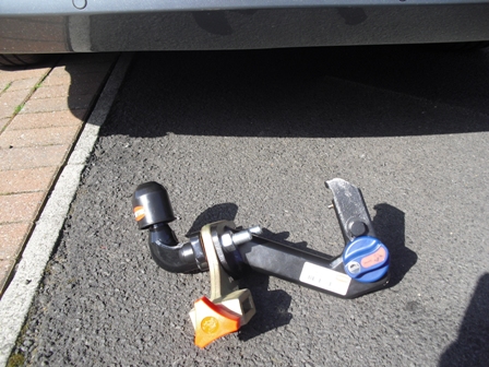

here they are..hopefully
My stabiliser bar has a slightly different fitting but I think that may be exactly what I am after!  Thank you very much indeed.
So that is a Witter detachable flange type?  My head is spinning with all the options but with the Superb being a taxi it would be handy not to have a ball there permanently as I will skelp my  shin as will customers which is not so good! :)
your existing stabiliser bracket will fit onto this one via the 2 bolts (as it is currently)
as far as reversing sensors is concerned..mine hasn't been recoded to tell the car its got a tow bar..just as easy to disable the buzzer on the screen as & when you reverse with the caravan on
