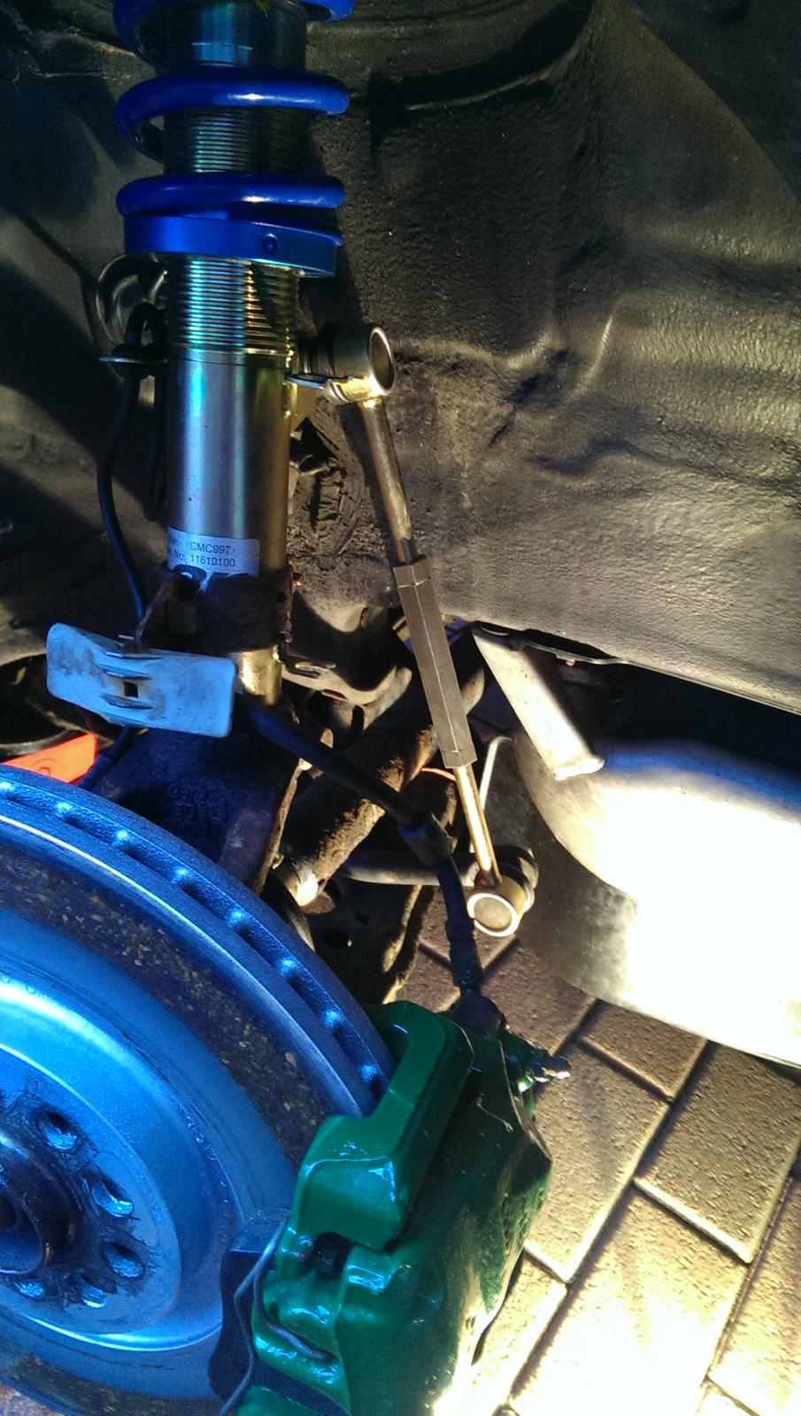

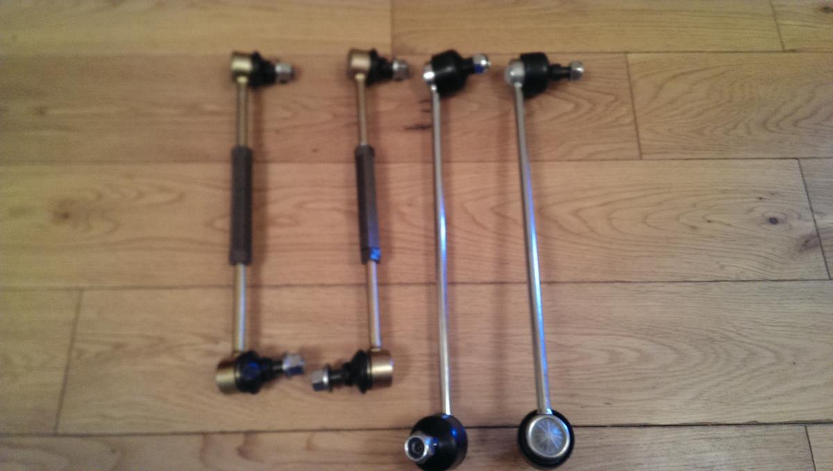

Had the same problem with my drop my vrs on APs........ I got 250mm short drop links with kit.....but where to short  :wall: ....so put o/e ones on to find them to be to long   :swear:  So after a few days pulling my hair out i ended up going to my local engineering company and asking them to make me 300mm long adjustable ones so i can get them just right..
Have a look....see if this helps.post-98702-0-00156900-1394840200_thumb.jpgpost-98702-0-59350300-1394840339_thumb.jpg

This is how mine is currently sitting at the minute. Just measured my droplinks and theyre 250mm so maybe look at changing them?!

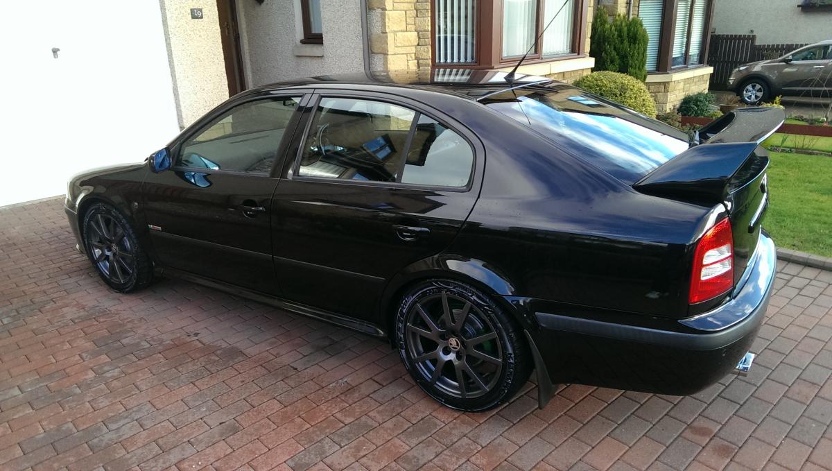

This is mine sitting on Prosport coilovers and Vito droplink. No rubbing on driveshafts at all. Could quite easily go lower if the roads round here allowed it.

Hmmm, Decender that looks spot on! Id love mine sitting like that! Dsmith if I had mine that low round here my bumper wouldn't exist anymore haha! I think im going to have to look at changing the droplinks! Maybe get some adjustable ones or something! The whole subframe etc is being replaced by the LCR one in the next few months so hopefully when its all down I might be able to see if there's any marks underneath! Thanks for the help guys! I appreciate it!
Looking good there mate think the front needs to come down a bit more.
What size wheels are those? I've been looking at a set of those in 19".
There 8.5x18 ET25 merc fitment ;)
Fronts do need to come down a touch more now it's settled tbh.
Got to be carefull as there's a bit of poke.
