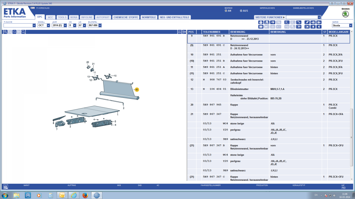

look on number 9 I assume that it is this
As per my local dealer the seperating net cannot be fitted retro, the dog guard is just a normal extra that you can always buy.
