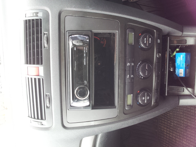

Headunit change is easy, took about half hour to swap mine for my Pioneer single din and sort a switched live, and parts were £15 for the Connects2 conversion bits :)

For info, this is mine with the Connects2 single DIN parts, theres also a piggy nack in the fusebox for a switched live aswell. It's not a perfect match, but then my car isn't exactly immaculate :D
Well done. Just need something to fill the gap in the dash now, either a pocket or maybe slide the auto changer in there. I've just received a new centre vent console as I have 2 broken fins in mine and the chrome has come off the little trim on the flap cover so hopefully the aux connector will arrive tomorrow then I'll fit that, drill a small hole into that pocket above the heaters and place the aux cable in there so it's nice and tidy.

I have the pocket thing in there, left it in the kitchen when I took the pic :/
